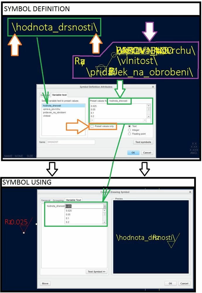

Hello @ifomenko
 picture bellow describes some basics about symbols grouping and variables. More complex symbols are defined with thise two abilities in order to reach predefined statements.
Variables:
- name of text string that will be variable is defined between slashes - \\
- define preset values in SYMBOL DEFINITION ATTRIBUTES window (you can also lock ONLY PRESET VALUES)
 Grouping:
- more complex symbols are like "hairy pile" of variable texts (see purple frame in picture above)
- due SYMBOL DEFINITION ATTRIBUTES you can filter what to show / hide
- due Variables you can set desired value for specific part of symbol, that has been filtered in grouping
Conclusion:
Variable is used for more complex symblos with predefined values.
Hope it helps
Regards
@mbonka
