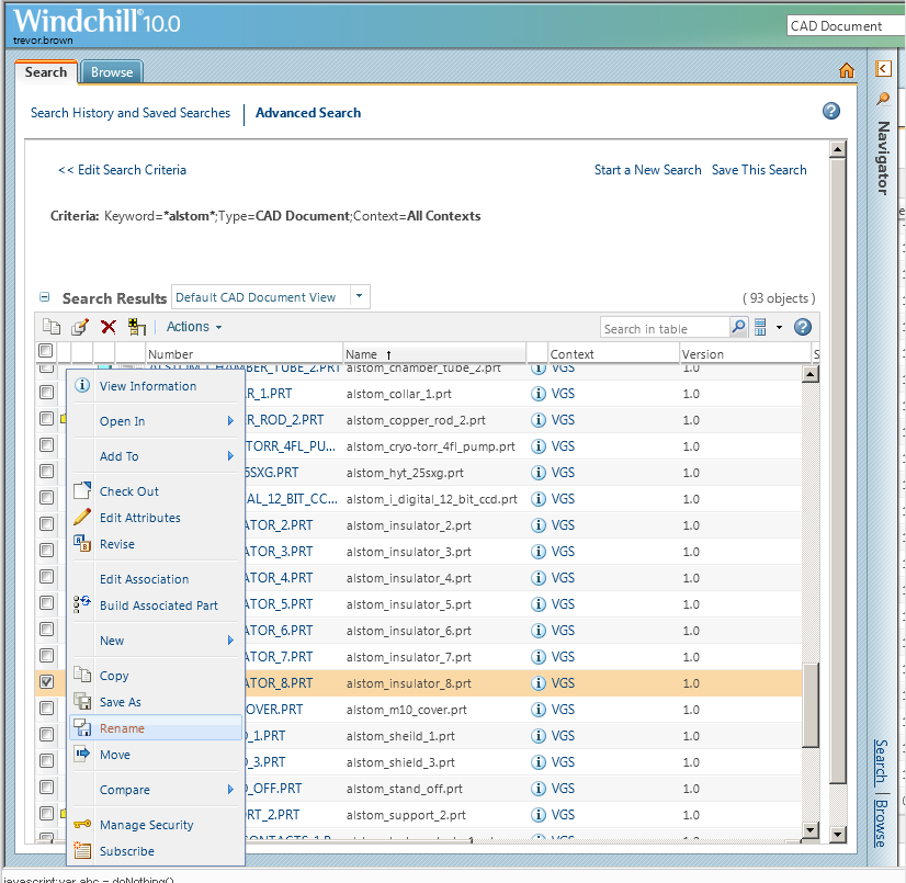

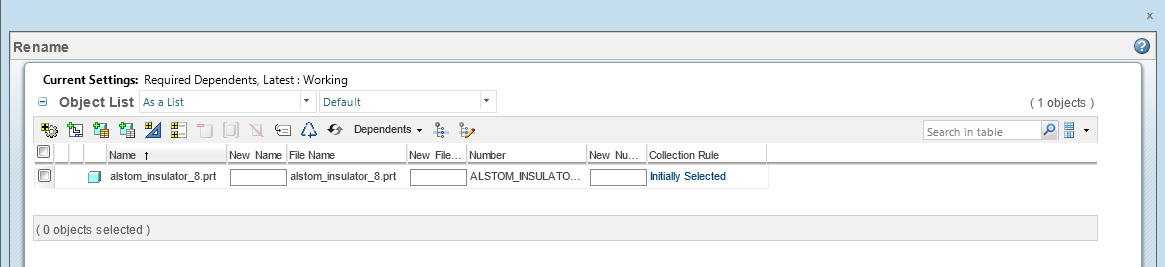

After much back-and-forth, looks like he was looking to rename a part in Windchill
Renaming is done by searching for the Part, selecting the Part, right click the mouse, in the window you have the rename option. Open that option and rename the part.

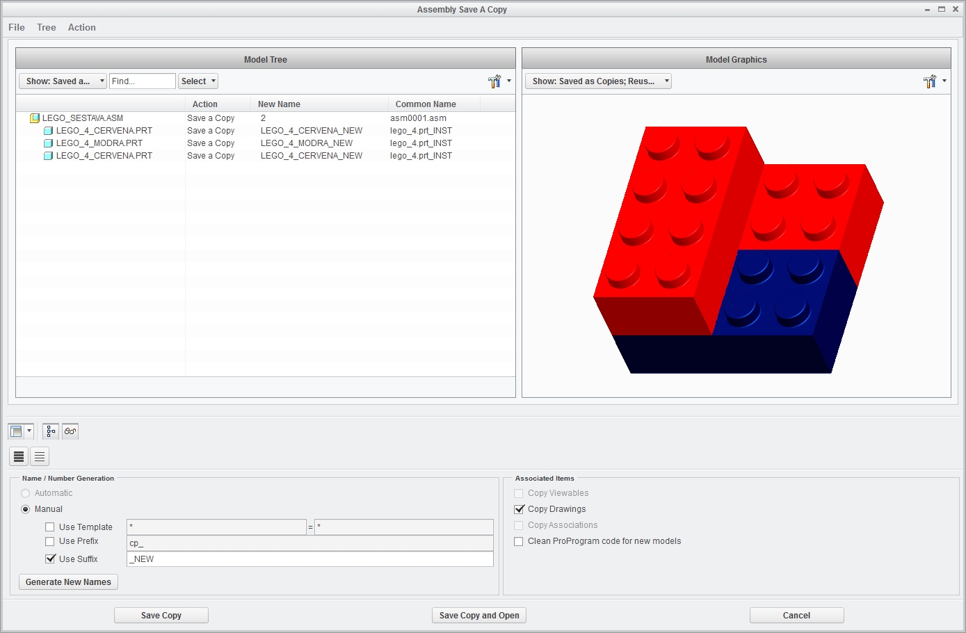

October 23, 2012
And what about Assembly Save a Copy. You can tick (Copy Drawings) in Associated Items box.
However I am not sure with WF4.
