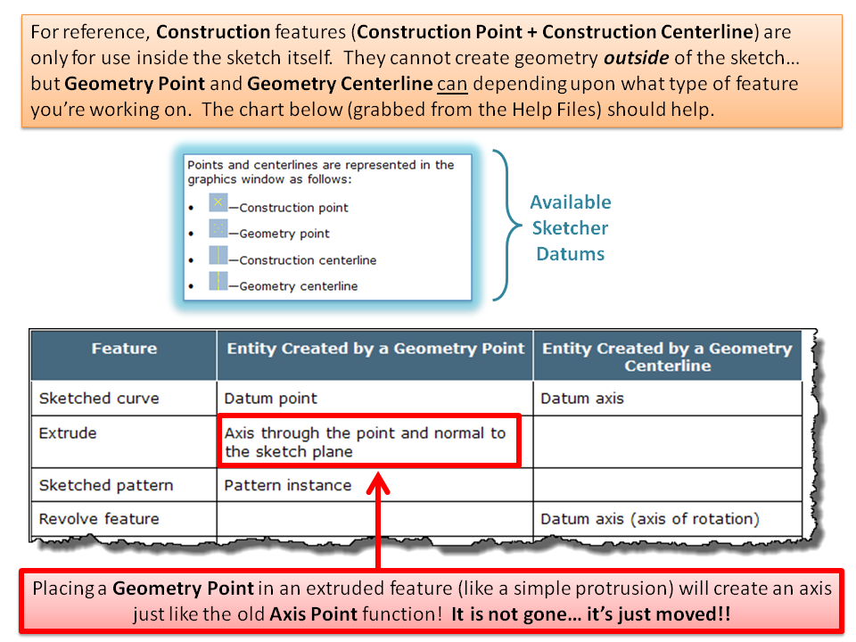

The Axis Point feature is not gone, it's simply been moved under Geometry Point. But, remember you can't drop a geometry point in a standalone sketch. You can only do it in the internal sketch of an extrude feature. This has always been the case. In my opinion, this is one fantastic reason never to use external sketches.
The show_axes_for_extr_arcs option works... but I find it quite annoying. I like having the control to place an axis point where I need it... rather than having an axis created for me through every extruded arc. Check out the slide below. Click the graphic for a larger, more readable view.
Thanks!
-Brian
