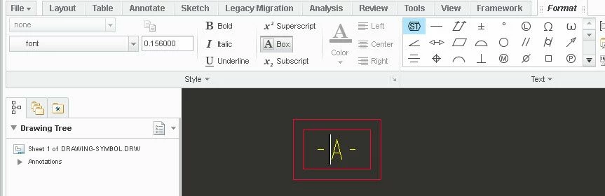

If you are just looking for the datum plane identifiers, just type them in a note using BOX function.
You can actually make all your GD&T using notes in the box function

Thanks Stephen, you rock!
this is a good work around 🙂
