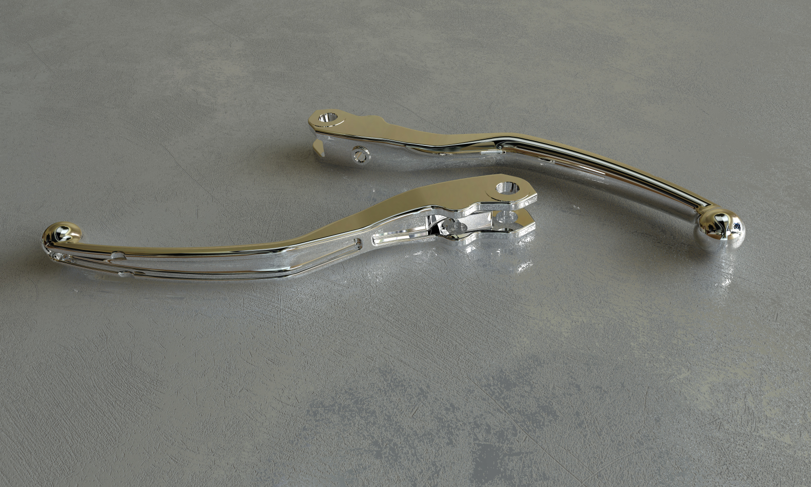

Try to find the motorbike on this pictures
New render with Creo Parametric 2.0
April 13, 2012
Here it is :
April 13, 2012
Good job VladimirN

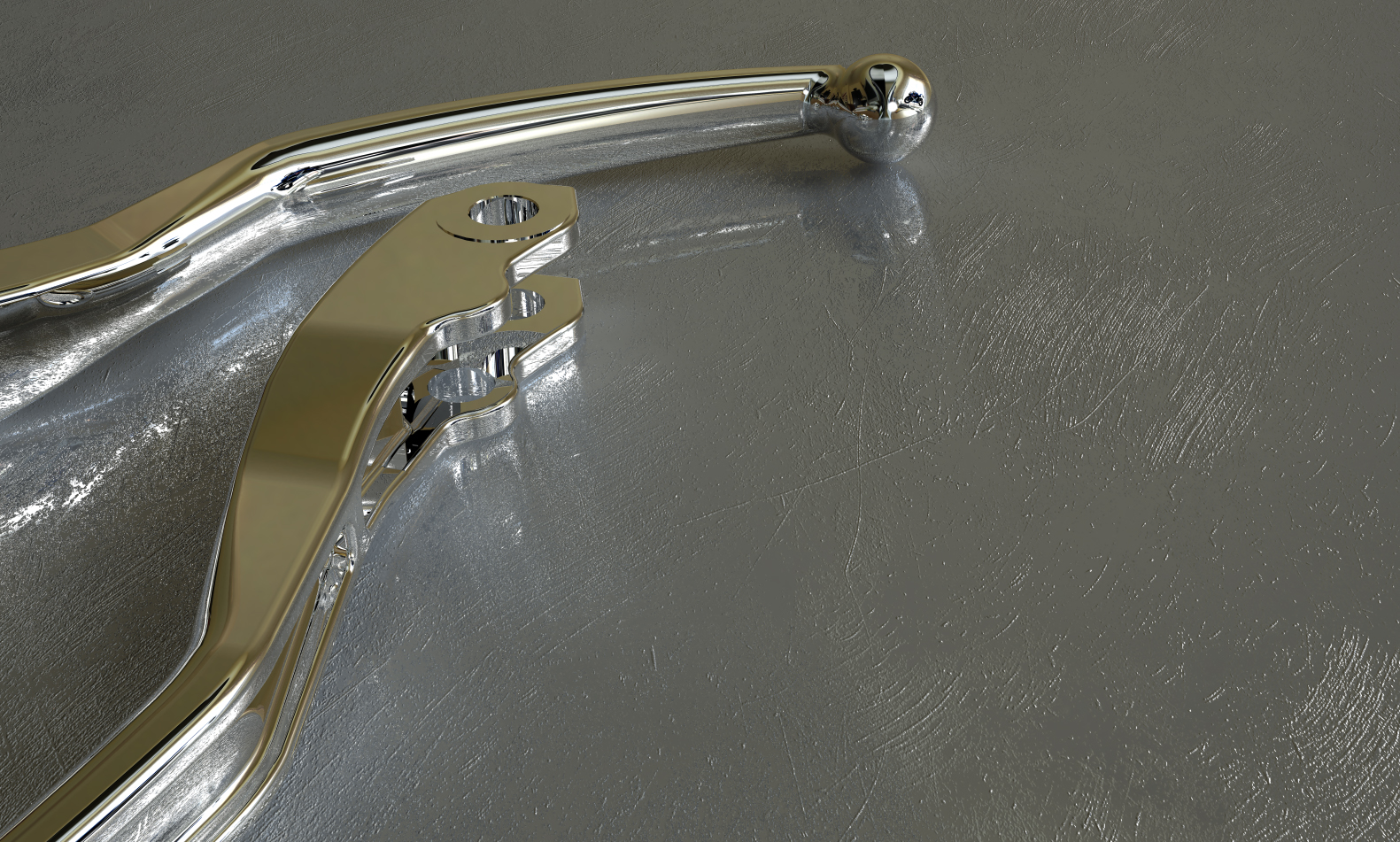

... and here
Note: My plan was to create a perfect reflection
