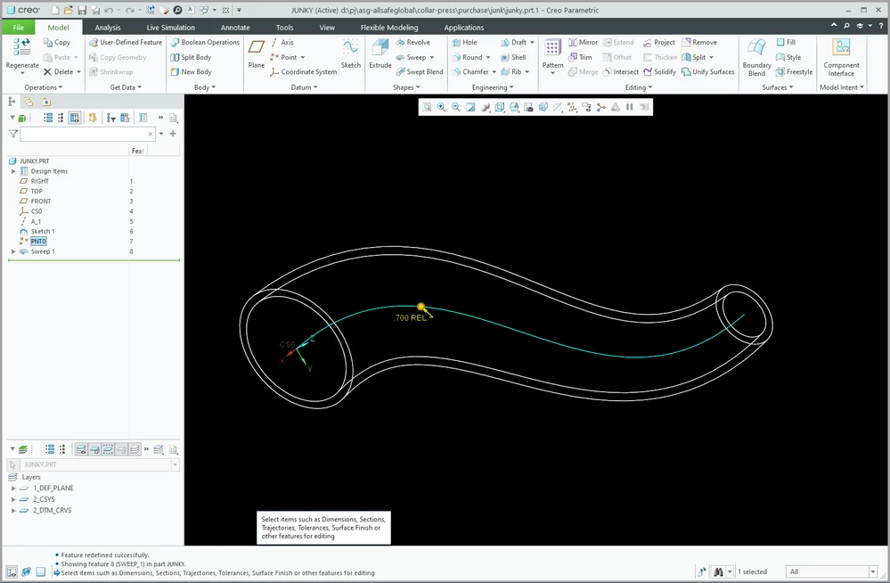

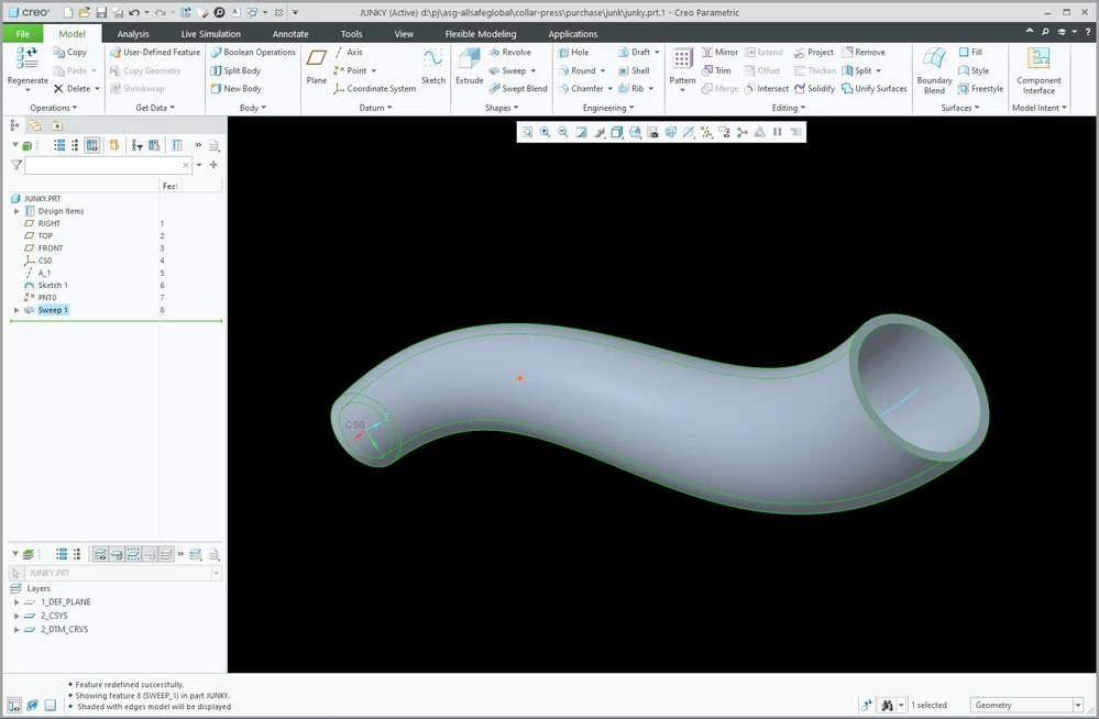

The direction of proximal and distal ends of the trajectory do change when using the flip direction option on the trajectory inside a sweep feature. This can be verified visually by a variable section sweep using trajpar to drive the value in the sketch. This will change which end of the curve is used as the "zero" value for trajpar.
The point (70%) you reference is defined before your creation of the sweep, so it is not dependent on the start point of the sweep feature. The offset reference for the point can be flipped if you need to relocate that point relative to a flipped trajectory start point. I am not clear why you expect the 70% point to move with the features you have shown in your model tree.

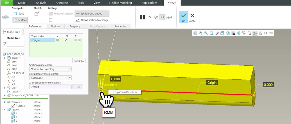

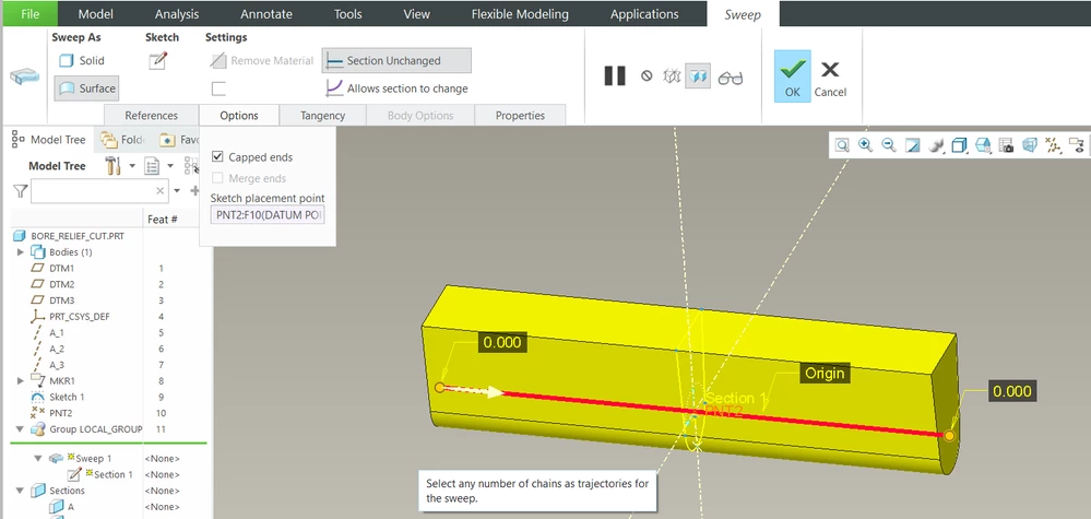

If you want to flip the direction on a sweep trajectory, use the RMB to get the flip option.
To set an interior point on the sweep trajectory for the sketch plane, use the options tab.

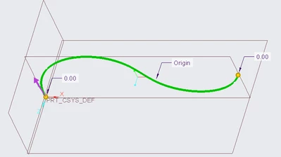

@ByDesign wrote:
I'm looking for what used to be called "Start Point" in sketcher -- or some other way to tell Creo where to put the sketch on a trajectory.  I see the  Setup > Feature Tools > Start Point, but it's always grayed out, not available.  I want Creo to put the sweep sketch at the other end of the sketched trajectory.
In a search, I found another post about this, but the answer is for a much older version, so doesn't seem to work with Creo 9.  Is it another silly hidden magic click?  Or a completely different process?  Thanks.
In Creo 9.0.2.0 I place mouse cursor on magenta arrow and click left mouse button. This action moves magenta arrow to opposite endpoint.
Notes:
  • my first feature is Sketch containing single spline
  • my second feature is Sweep using Sketch

Based on @MartinHanak observation from Creo 9 UI, it is working the same as is seen in Creo 7. The LMB or RMB can be used to move the start point on a trajectory. The LMB is faster as it is a single click.

Thank you @tbraxton .  What you say is kind of what I was originally expecting.  I tried so many combinations of clicking and LMB, MMB, RMB.  In the sketch, or outside the sketch, Click and it changes color so you think something is happening, but the colors are apparently meaningless.  I see in the images below (your second post) -- which are very interesting, thank you, but I can't duplicate that behavior with the RMB.  There may be changes for Creo 9.
I appreciate the time in sending the sample images.  I messed with the options as you show, which is interesting.  I can see how that might be useful sometime.  The options do provide a way to move the section, but it does not change the direction of the trajectory -- which IDK, maybe it's meaningless in light of the answer noted by @MartinHanak .  You can see what Creo thinks is the direction by looking at the 70% point in the attached image.  Creo thinks the start of that curve is on the right.  In previous versions, you could define the start in sketcher by choosing an end and defining it as the "Start Point".
