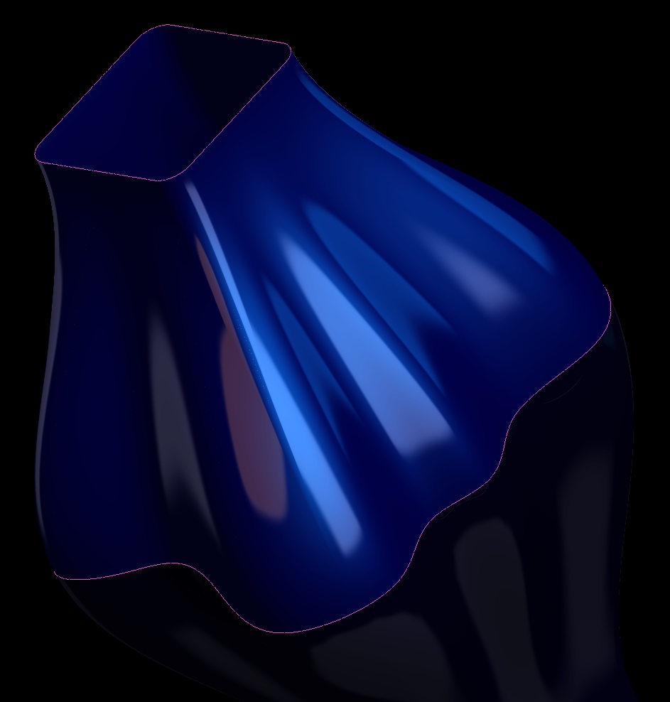

...or you could use a VSS.....
Patriot_1776
July 30, 2015
...Like this surface (easily "closed" to be a solid)....
July 30, 2015
Frank,
In Creo, the VSS command is gone; PTC reworked the sweep and blend commands.
Regardless of all that, what did you use to generate that render?
Patriot_1776
July 30, 2015
Well, I'm on creo elements/pro 5.0, whatever the h3ll that means now.  I know it's a couple revs behind.  Hopefully they have taken the VSS capabilities and just moved them.  It's one of their most powerful tools.  If it's gone, I'm gonna be totally p!$$ed.
Just added a color and turned on the "Enhanced Realism) with the shade quality set to 10, nothing special.  I'd rather put my effort into the model, not the rendering.
