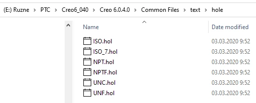

March 18, 2020
hole table files are file located in <CREO_LOADPOINT>\Creo 6.0.x.0\Common Files\text\hole directory, for example:
