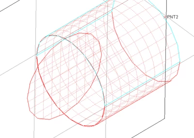

This is my first time to create surfaces in CREO. The below is what I got: why the surfaces don't have shade?
Without clicking on these surfaces, they will disappear as like the below: why are they invisible? How to know the locations of these surfaces
Where is the switch to turn the surfaces on and become visible?

There are many things that could cause this problem.
Set the display to wire frame. If they are not visible after this then check to make sure they are not on a layer that is hidden.

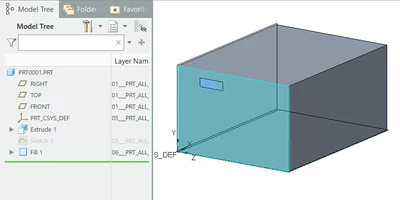

The cylindrical surface was created through Extrude. The plane surfaces were created through Fill.
Right now everything is normal. I can't find a way to make the surfaces disappear except for put them on a layer then turn the layer as hide
Aug 10, 2022 6:44 PM UTC
I was learning how to create an isolated small surface "region" in a big surface like the small rectangular surface patch on the above enclosure. I am going to export its step file into ANSYS then mesh the small patch and name it as "leak inlet", so that it can be used in CFD simulation as an inlet BC. However, I am not sure whether this approach works.

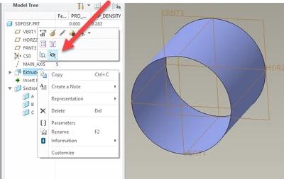

Layers are the typical way of handling visibility of surfaces.
You should also be able to RMB  Hide
