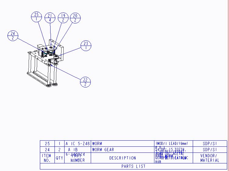

Why does regenerating garble the additional segments of a paginated table?
  • September 15, 2014
  • 1158 views

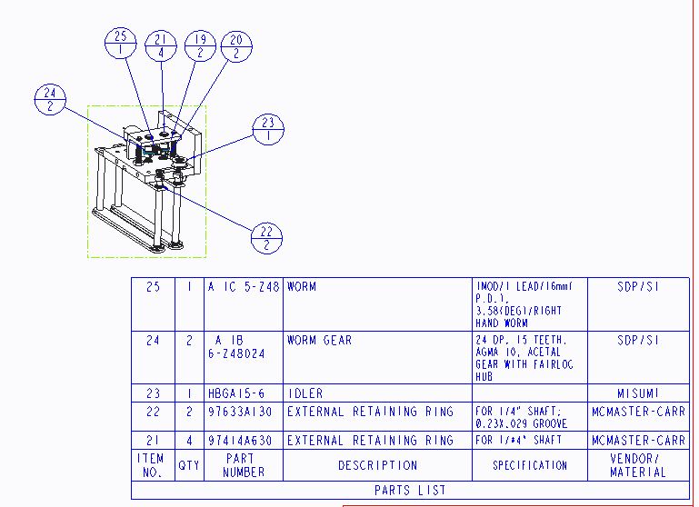

Paginated BOM:
Regneration gives this:
The only way I can clear up the BOM is to re-set the extent of table. I am new to Creo 2.0; however, I used Wildfire for many years. The issue wasn't something I encountered in Wildfire, but I have noticed that table pagination is a different.
