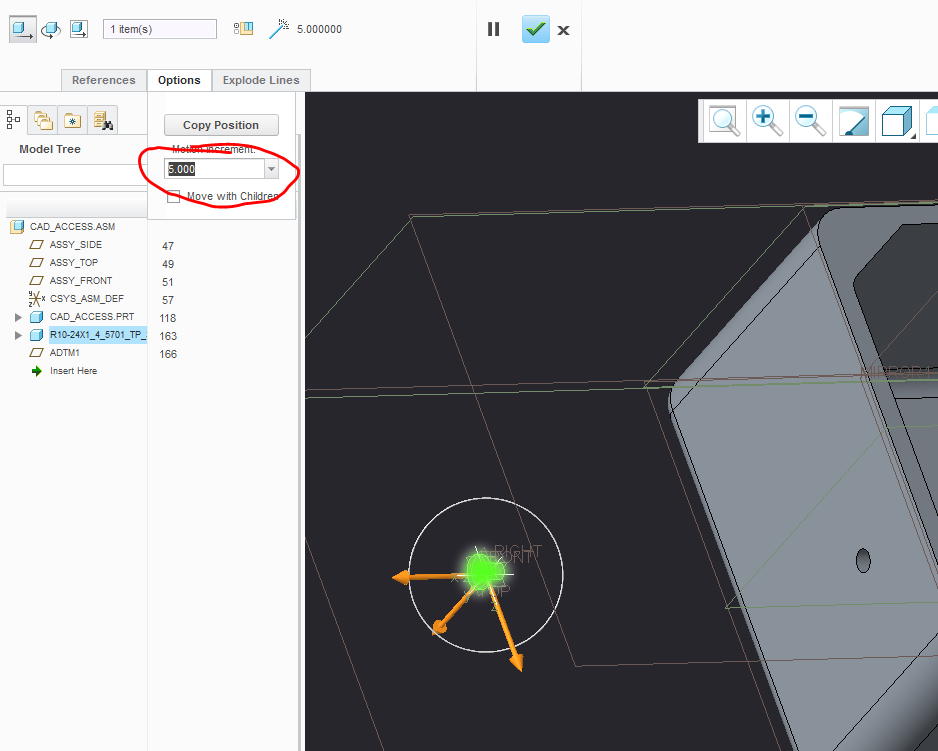

February 22, 2017
In the Edit Position dashboard go into Options and you can put whatever increment you want then pull the arrow for the direction and it will move that increment.You might need to move the component back to "Home" first then you can set that increment.
