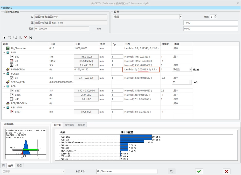

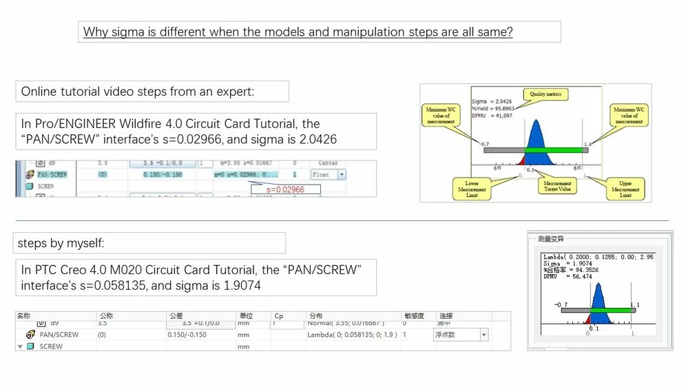

Why sigma is different when the models and manipulation steps are all same in TAE?
  • August 13, 2017
  • 0 replies
  • 959 views
When i try to do practise in Creo Parametric Tolerance Analysis CircuitCard Project, i find that my result sigma value is different from the PTC offical help documents' result. But i almost can make sure that my operation is same as the PTC offical help instructions. I have tried for more than 10 times but still different, now i really need friends help me.
Here is the PTC offical sample model file's download web link:http://support.ptc.com/help/creo/creo_pma/chinese_cn/model_analysis/tolerance_analysis/tolerance_analysis-rds.xml.ditaLinks/circuitcard-models.zip
In the attatchment is the models with tolerance analysis result of circuitcard-models doing by myself.Why sigma is different when the models and manipulation steps are all same .jpg
Thank you.
