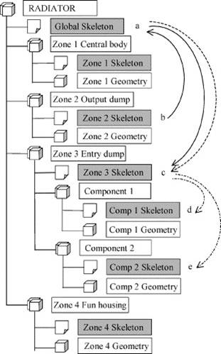

I found an image online showing a Skeleton Structure. It shows what I was asking about...
Does each part now have to be in its own asy with it's own skeleton that references back to the master skeleton (called Global Skeleton in the image)?
OR
Can the structure be flat, with all the parts using external copy geoms of the same Skeleton?

A skeleton is a special kind of part file where the definition for your assembly lives. It allows you to lay out once the critical geometry that two or more parts share like outer surface contours, parting lines, hole locations, etc. It is typically only non-solid geometry - surfaces, planes, curves, axis, etc. - but there is no restriction on what kind of features you can put into a skeleton. Geometry is passed down through the use of publish geometry and copy geometry pairs.
A skeleton part behaves in some specific ways. It assembles in the default location ahead of the default datums. It is ignored by default for mass properties analyses, even if it has solid geometry. It can be filtered out of BOM tables and reports.
The use of a skeleton is one method, a powerful one, to implement top down design. There are many ways to do so. One is to have a single top level skeleton and pass the geometry down to all parts at any level in the assembly tree. The advantage is a simpler structure - you have a single skeleton with all shared geometry. The disadvantage is that every component is a direct child of the top level assy and requires it to be updated. A variation of this is to use the same skeleton at each level of the assy.
Another is to have a separate skeleton at each sub assy in the tree. You'd then pass the sub assembly's required geometry info form the top level skeleton to the subassy skeletons. You might then add geometry there that only is required at that level. Components then get their geometry from the skeleton in the assembly in which they reside, either the top level or a sub assy. The advantage is that each sub assy has the geometry it needs to regenerate. If a change is required at the sub assy level only, it can be made in that sub assy skeleton and that sub assy regenerated. Only true top level changes would require regeneration of the full assy. The disadvantage is a significantly more complicated assy.
The advantage of a skeleton over the master model technique (which I think is what you are referring to as 'reference part') is the ability to pass on only the geometry that the target component needs instead of the entire master model.

No, it makes she assy structure simpler but the skeleton itself more complex. It also makes small changes a bit harder as the entire assy must be regenerated even if the change only affects a couple parts in a sub assy.
Would every part now have to have its own assy with a skeleton that copies from the higher skeleton?
No, there would be no advantage in doing that. There si some advantage, as stated above, for each sub assy having its own skeleton.

Further to what Doug has said, I would suggest that using the same skeleton in the top-level assembly and multiple sub-assemblies makes it very difficult to avoid referencing the wrong one. When you click on the skeleton to select some part of it to reference, it is important that you select the skeleton that is in your sub-assembly, not the same skeleton that is in another sub-assembly, or in the top-level assembly. I have had recent experience of this, and it was tricky to avoid picking the wrong one.
In addition, if you use different skeletons for each sub-assembly, then, when you change one of them, the whole enormous assembly structure does not need to be regenerated, just the sub-assembly that is affected.
Having used both methods in two projects over that last few months, I would, if I could, go back and change the 'single-skeleton' model to a 'multi-skeleton' model. The latter has proved much more manageable.

This can also be handled by using publish geoms and referencing the pulish geom in your copy geom by picking in the model tree. or, by opening the sub assy adn making hte copy geom there.
I would never reference a skeleon directly, except for assy references. Alsways use copy geom & publish geom pairs. Much more manageable.
That brings up another point. When using a skeleton, it's important to assemble components only to the assy or sub assy default datums or to the skeleton itself. Do not constrain part to part or you may find yourself creating circularreferences.
