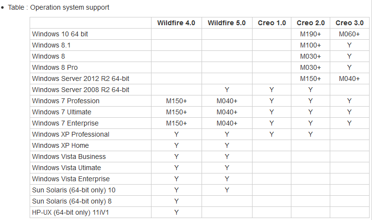

WF2 was released in 2003 and went out of maintenance in early 2008.  It's been unsupported for 8 years, it's more than a little bit old.
In fact, Windows 7 wasn't released until late 2009, so it wasn't even designed with Win 7 in mind.  You might get Win 10 to work, but I would stick with Win 7.

Refer to this PTC Document - CS55934.
https://support.ptc.com/appserver/cs/view/solution.jsp?n=CS55934

We all know that there is "Not Supported" and then there is "Not Working"   We have upgraded a few Wildfire 5.0 machines to Windows 10 and so far it seems to work okay.  Depending how far you wander off the path, it may or may not work for you.
One thing with Windows 10 is the mouse settings need to be looked at.  Go to SETTINGS > DEVICES > MOUSE & TOUCHPAD. Turn off “Scroll inactive windows when I hover over them”

I got Wildfire 2.0 32bit to work on Windows 10 64bit.
I learned for a post that is was quite easy to do after spending a long time trying and failing.
The trick is don't install Wildfire 2 from your hard drive.  Install it from a thumb drive.
It is that simple.  However, I have not been able to install Wildfire 2.0 64bit on Windows 10 64bit.
