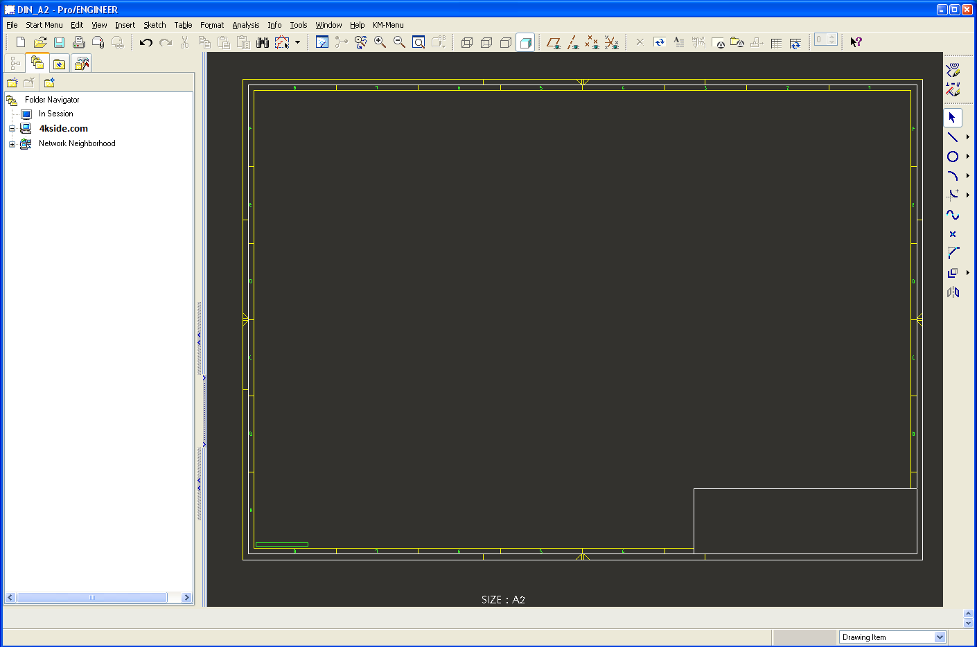

This may be a long shot but I am wondering if anyone has any
old drawing boarders in wildfire 2 format?
If so would they be willing to share the files I require all
sizes
Many thanks in advance
Best answer by VladimirPalffy
Hi Colin,
Select link and download DIN formats (A0 - A4) created in ProE Wildfire 2.0 - download here : http://4kside.com/onewebmedia/download/drawing_formats_wf2.zip
For example: din_a2.frm
Vladimir
