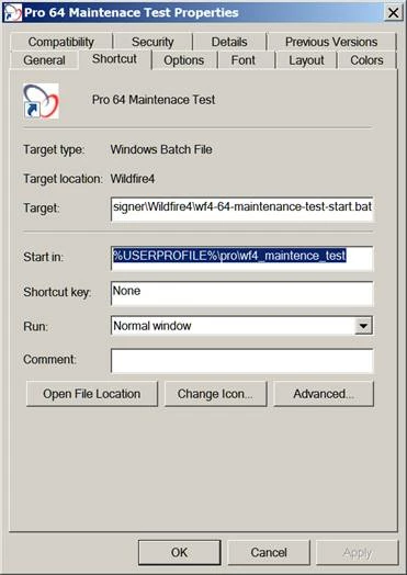

Your startup script for ProE can reset the location of this cache file using the command:
set PTC_WF_ROOT=%USERPROFILE%\pro\wf4_maintenance_test\PDMLink_Cache\PTC\ProENGINEER
This allows you to set up different environments for various uses.
As you can see from the command above I have one for testing new maintenance builds of ProE. I also have commands to test our PDMLink QA and Dev servers, each with its own cache.
My suggestion is that you use a startup command for windchill that sets the location somewhere other than default.
You have to also be careful that you never connect to Windchill from the ProE session you want independent. If you do the cache will retain that information and want you to log in the next time.

I have a shortcut of that on the desktop that has the startin folder set to where I want the home working directory for ProE. This can be different for each startup script.
