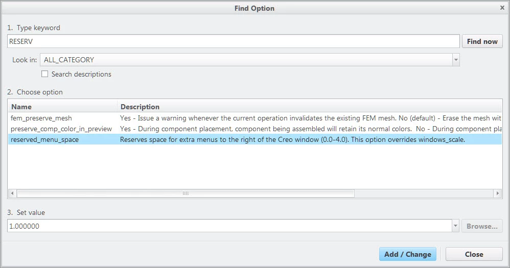

in Creo 4.0 (M040) the window size between model (blue) and drawing (black) mode window have a different sizecreo_window_size.PNG (See picture).
from Creo 2.0 I have set
windows_scale 1
menu_manager_position adaptive
thermo_position_hint no_window_overlap
attach_menumanager yes
I would like to have the same size for all windows and some space to the right for the menu manager. Something must have changed from Creo 2.0 to 4.0?

I can't reproduce your problem using my CR4 M040 installation. Start investigation without your config.pro.
April 17, 2018
Thank's for the reply. I started with an almost empty config.pro - but no change. I noticed the difference of the graphic window size between model and drawing mode only arise in a so called linked session of Creo and PDMLink. In stand alone Creo I don't see this behavior.
Jan
April 19, 2018
Try setting the config.pro option
reserved_menu_space
