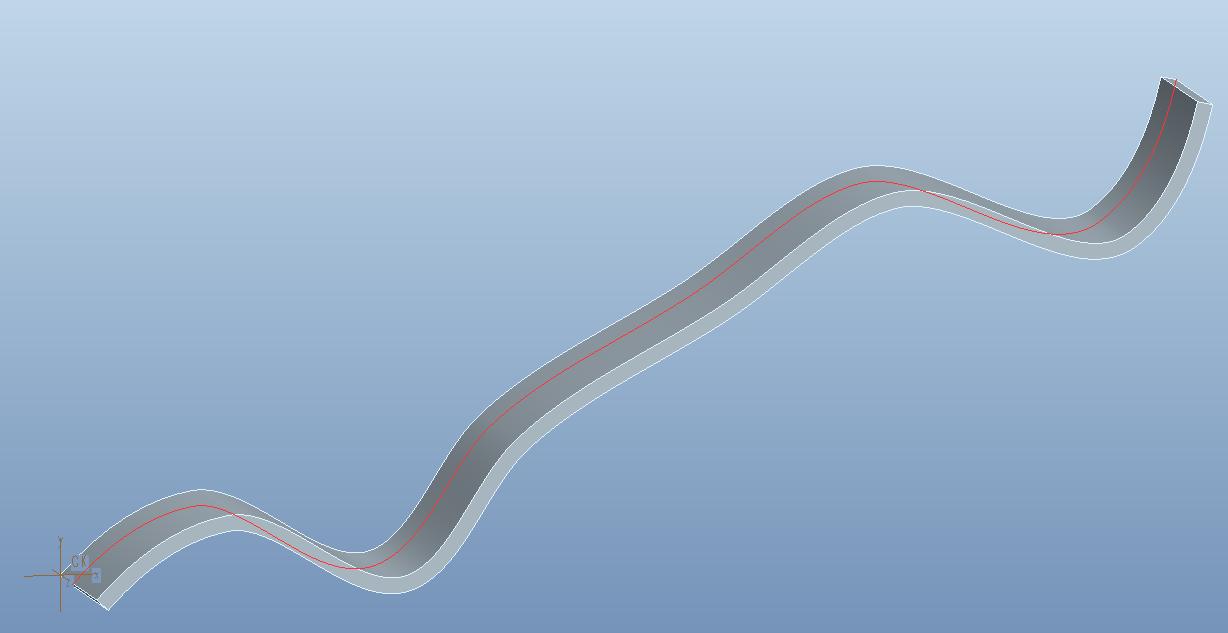

Hello!
Using the STEP format I import into Pro/E part, which, accordingly, has no history of creation. In a new sketch I projecting one of the edges of the parts. Next, I want to know the coordinates of the curve relative to the axes X / Y, but with a certain step / interval, for example, every 0,5 mm. How to implement it in Pro / E (may need to use export to text file formats). Any ideas?

Thank you for your help. I think this is a tricky way to solve this problem. The main idea of the solution consists that I needed a lot of points (for accuracy), and also it is necessary to automate process of transfer of coordinates of points (manually specify each desired point is impossible). Can you please attach the document ".prt" of your solution?

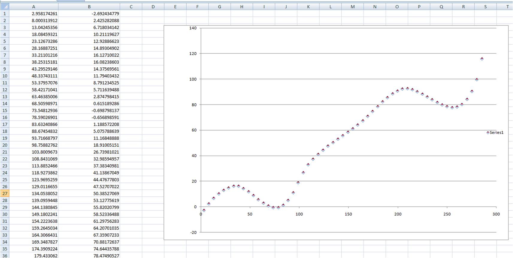

Another way of doing it would be to create a UDA. You can create graphs of the X/Y data in seperate plots and export to excel. The setup would be similar to method David mentioned.
VladimirN24-Ruby IVAuthor
July 14, 2011
Kevin, hello!
Kevin wrote:
Another way of doing it would be to create a UDA. You can create graphs of the X/Y data in seperate plots and export to excel..
I understand that all these options are available in the module of Pro/E "Behavioral Modeler"?
July 15, 2011
Yes. Here is the file you posted with a UDA. To see the plots in ProE select the User Defined Analysis icon or you can find in under the Analysis menu. In the dialog box that comes up there is a Saved Analysis section that shas two analyses for the X and Y data plots. You can retrieve the data and a plot will be generated. You can export the data to excel format. You need to combine the X and Y data to generate a plot and you should get something similar to this:

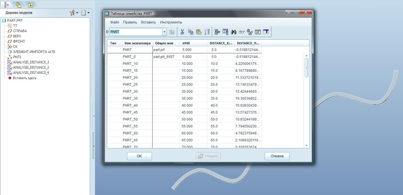

So, my colleagues have prompted to me as it is possible to automate the process of obtaining the coordinates X/Y with the desired curve. The basic idea is to use the "Analysis Feature", and then create and work with the "Family Table".
July 14, 2011
Very clever, Vladimir! Using a Family Table in that way was a great idea.
July 15, 2011
Thanks, David. It would also be interesting to see the implementation of the method proposed by Kevin:
You can create graphs of the X / Y data in seperate plots and export to excel.
P.S. In the files attached above two variants are considered:
1. The step for each of points makes 5 mm.
2. The relative step 0,01 for curve breakdown is used.
