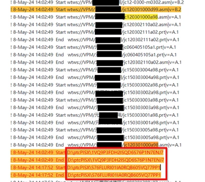

Hello, I have some performance issues with Creo working with Windchill:
When I open an assembly 3D model with Windchill, sometimes it takes a very long time (about 15 minutes), but other times it is quite fast.
So, I checked the trail file to find out what happened when Creo opened slowly.
The trail file shows:
After Creo loads "jc120301000a98," it tries to load some items from my local disk, taking 15 minutes.
My questions are:
  1.  What are these local items?
  2. Why does Creo try to load them from my local file system (the directory is where my "config.pro" is located)?
  3. Why does it sometimes take a long time and other times load very fast? Is there a method to avoid the long loading times?
  4. When I try to open this assembly 3D model in a local folder, Creo also tries to load these items.
And here is the structure tree:

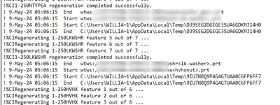

I'm on Creo 6 and windchill. I see similar in my trail file. I don't know what those are. You would probably have to ask PTC specifically.
From a loading time perspective, here are my thoughts:
1. Creo installs that are on the network instead of local installs are generally expected to be slower (this may not be much of a difference)
2. Large workspaces will load significantly slower.
3. too many workspaces will cause issues
4. Model errors/warnings/failures will significantly impact loading times.
5. Assembly features will significantly impact loading times (i haven't tested this specifically in a long time but I don't expect it has changed)
6. old workspaces tend to be problematic, especially from before windchill updates
I'm sure there are a huge number of other reasons for slow loading.
Had to blur a couple of spots due to a customer name.
