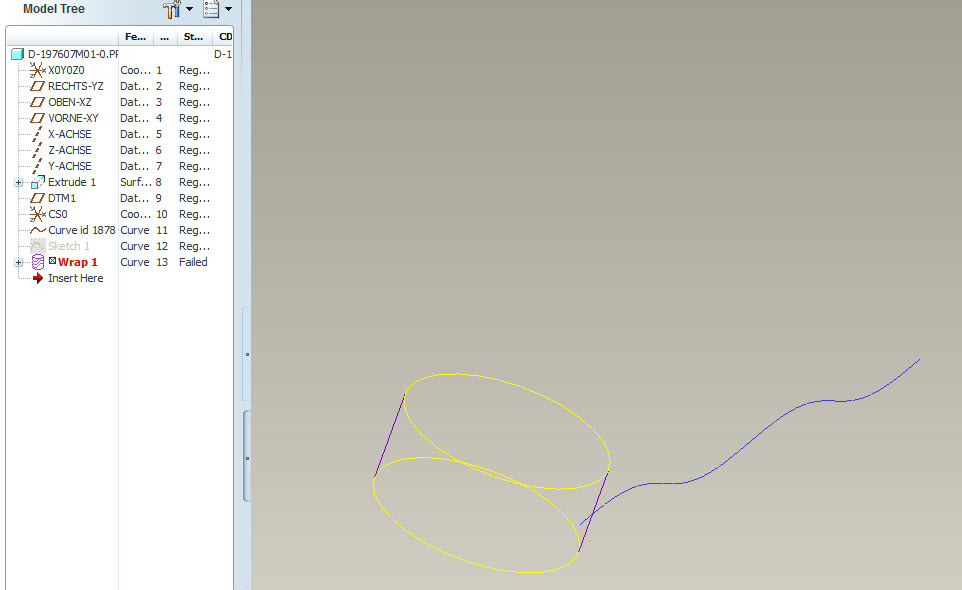

I am having a problem wrapping a datum curve around a cylindrical surface. Here is what I have so far. I need help with this. Thank you!

No time to open it - does the curve have a csys? I recall that that's the anchor to stick on the surface.
After that, select Edit/Wrap; I think it's easy from there.
May 30, 2014
Yes. The curve has csys.

Joseph,
As David and Steven mentioned, you need to create a datum csys in sketcher.
Redefine the sketch 2 in attached part and notice that there is a csys.
Check attached file.
May 31, 2014
Thank you Mahesh! So, you need to establish the csys in the sketch before you draw the sketch. Got it! Thank you for your help everyone!
