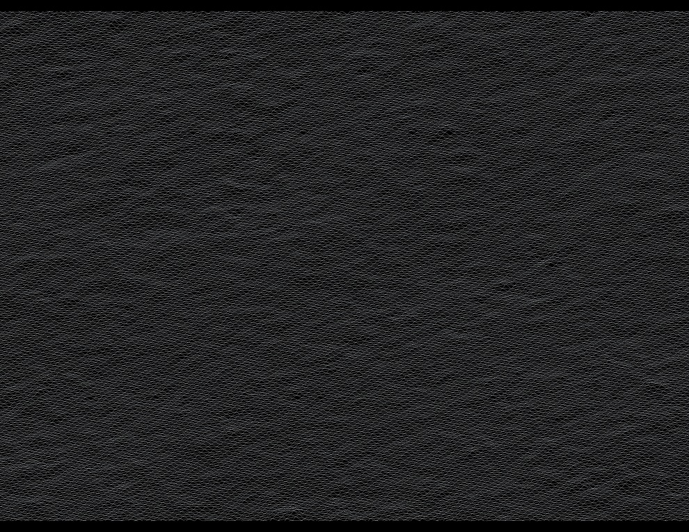

I have a quilt with approx. 2500 surfaces. This was a laser scan of a textured part. The file was flattened in Geomagic and exported out for me to work with.
What I have is a round core for a mold. The quilt needs to be projected to the core(above parting line).
Looking for ideas(of course, better then mine).

Welp, looks like 'Warp' is where I need to go with this.
Need to figure out how to use it with a spline(s).

if you have a decent quilt you can make a solid block and just solidify cut the quilt out and then move on. not sure why you would flatten it to work with it.

Hope this clarifies for the jokesters and everyone else that might have some input.
This is the quilt. There's over 2500 surfaces here.
This surface has been flattened in Geomagic so we can manipulate......In Geomagic. Not ProE.
The warp feature in Pro will bend, but I can't get it to work with splines for an accurate wrap.

Why??? Texture is almost never added to a part. They photo-etch it in the mold. IF, and that's a HUGE if, you can even do it somehow, it's going to be so distorted from the original "flatten" back to the final "wrap" as to be completely useless. I seriously doubt Pro/E could even do so many faces.

I'm well aware of texturing. We have a laser for this.
The term "textured" that I used was the only way for me to describe the quilt.
Ufortunately, I cant't get into detail of this project.
The goal is to get the surface from a flattened state to a wrapped.

Try a spinal or toroidial bend.
