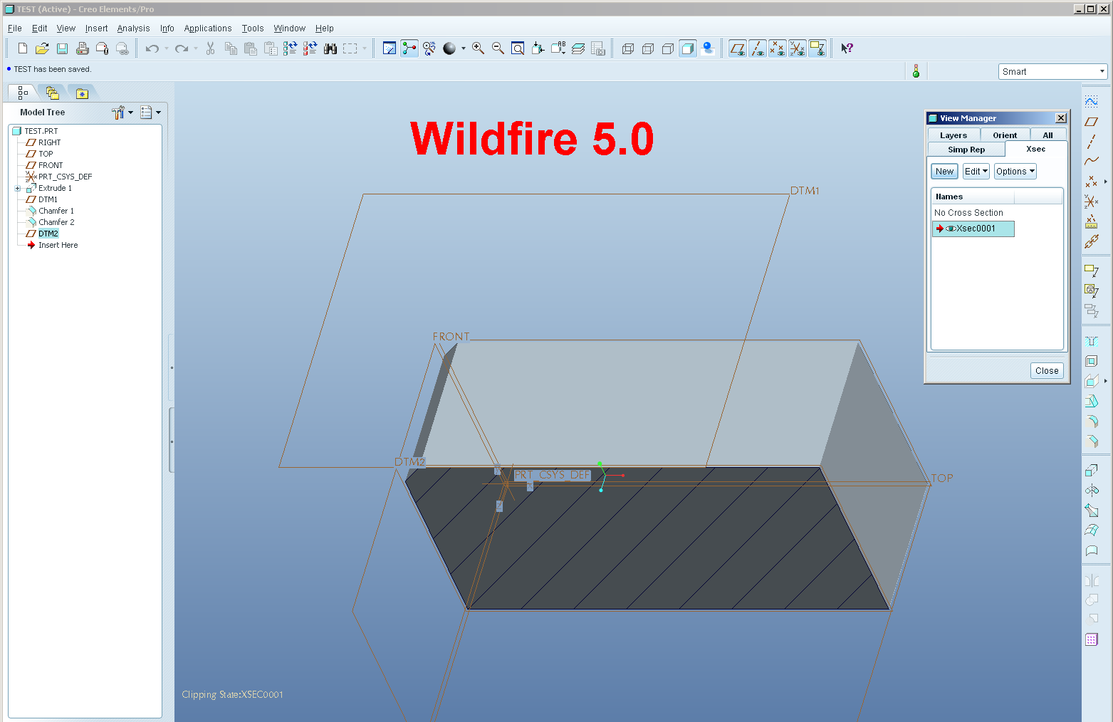

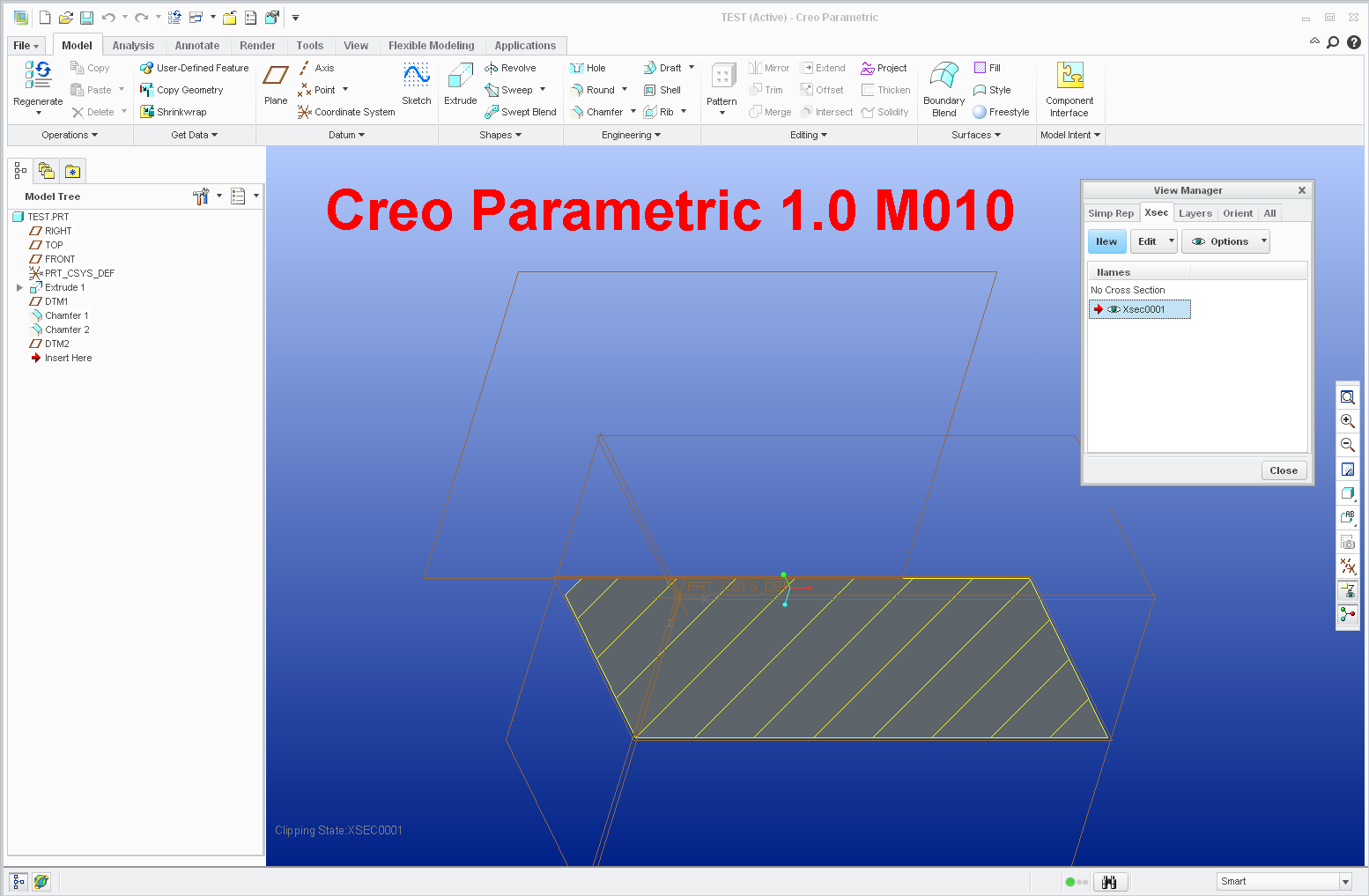

When I create Xsection in a part (in Creo Parametric 1.0 M010), then activate it and make it visible, I'll receive unexpected result. See two attached pictures. I guess it is a bug. What do you think about it ?
Martin Hanak
Best answer by MartinHanak
I forget to test the problem with config.pro option graphics win32_gdi ...
When I set this option then Xsection is displayed correctly (in Creo Parametric 1.0 M010).
This means that the problem is related to OPENGL graphics and I have to find the right driver for my graphic card.
Martin Hanak

I agree also I saw that solid model looks empty if you go to visibility in Creo!

not having any problems on x64 - can you post the part?
MartinHanak24-Ruby IIIAuthorAnswer
November 6, 2011
Martin Hanak
November 6, 2011
CREOp seems to be heavier on the graphics card - it defaults to transparency ON and uses this for mouse-over highliting - its faster with transparency off but solid highliting is unusable.
The graphics engine appears to be new and buggy - if I turn transparency off I cant get it back on via Model Display, have to go to the config.pro file and change it. Anti-aliasing (smooth lines) has a mind of its own as well - its fantastic in drawing mode when it works, but frequently switchs off for some unknown reason.
FX580 with Win7
