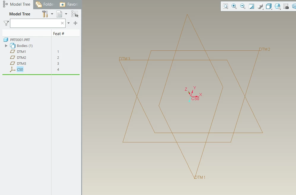

I have tried selecting "user defined" as standard orientation, but it will only turn x and y angle.
I have tried making own template part and template assembly and replaced the standard CSYS with one that has z as top (up). But then the actual system orientation is still Y up, and my exports will still be oriented wrong anyway.
So either choose to always have my exports in wrong orientation, or always view my models from wrong standard orientation
What are your best work around for this? 😃
tbraxton
tbraxtonAnswer
October 15, 2022

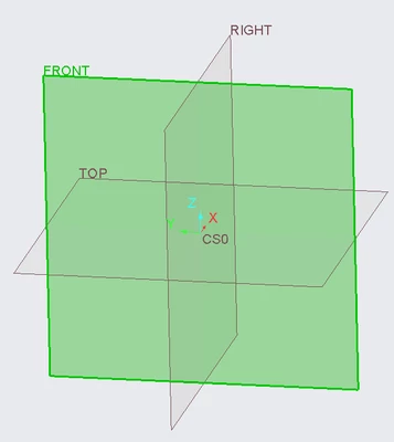

If you create a new start part, it is possible to orient the z-axis as required. Is this what you are trying to do? If so, the key is to create the default datums in an empty part before adding the csys to the model. See the model tree.
You can add CSYS features to control orientation and origin to support your workflow.  For your exports create a csys that has the z-axis oriented relative to the part geometry as required and use this csys for exports.

ISbitpro4-ParticipantAuthor
October 17, 2022
aha, so I will have to manually pick the only visible coordinate system in my model when exporting (to not default in to the invisible standard csys). Or as you say, use a macro.
Thank you for this work around! I will use it 😃

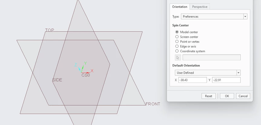

I don't care for simply reorienting the coordinate system because the internal (hidden) default csys is still pointing the wrong direction.  I prefer to use the default csys as-is and then name the planes so they agree with it.  To get things to show correctly in Creo, change the default orientation so that z is pointing up.  This can be done with the following config options:
  • orientation
  • x_angle
  • y_angle

Thank you for the user defined view orientation. I will give it another try!
I tried this and at first did not like it, because I could not possibly get the orientation as I wanted. It can only rotate around X and Y and for some weird reason not Z.
This is the orientation I want.
As you say, the internal default csys will be where it is. I will just have to learn to use Y as forward instead of side I guess...
I guess I will never understand why I have the option to add my own csys, and then Creo just ignores it and use its internal default csys anyway haha
