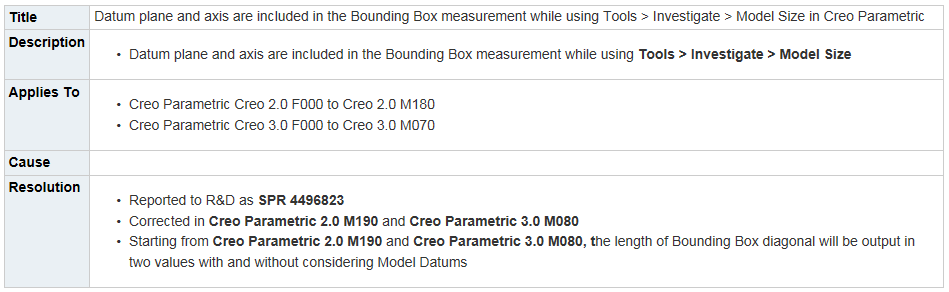

There was a recent change that allows datums to be excluded from the bounding box size calculations.
https://support.ptc.com/appserver/cs/view/solution.jsp?n=CS93540
March 5, 2016
If you don't have (or want to go to) these later builds, you can achieve similar results with Toolkit ($$$).
https://support.ptc.com/appserver/cs/view/solution.jsp?n=CS222336

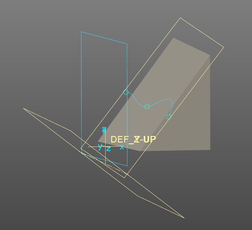

so here's the basic case - 3 points constrain the curve.  the curve is a spline that must be planar and NOT a combined projection for numerous reasons.  The configuration below was how it started, a moderate angle, no problem.

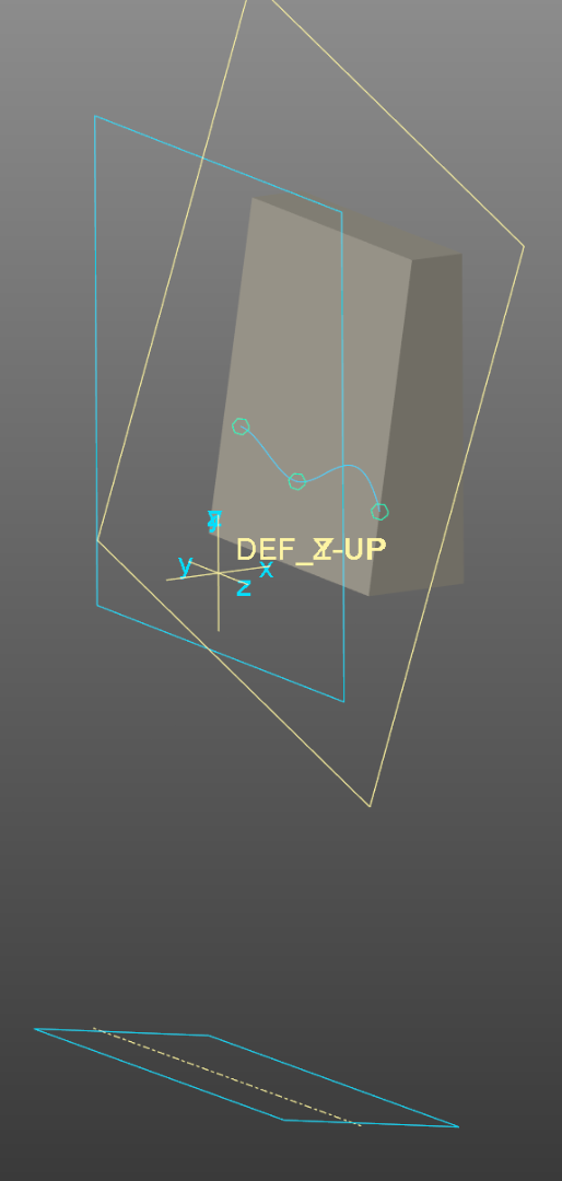

However, adjustments to the design required a much steeper angle, which brought me to the following and this isn't even as bad as it was to be honest.
the final conclusion was to re-define how the sketch plane was constructed entirely.  it isn't a problem, it's just tedious extra work for something that shouldn't be included in the bounding box if it's layered off.

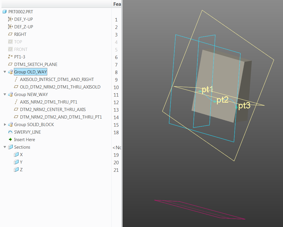

here was the final work-around which doesn't even require any hand-wavy nonsense of adjusting the plane's display-outline (which I'll admit can be very cool at times, but not very well parametric.

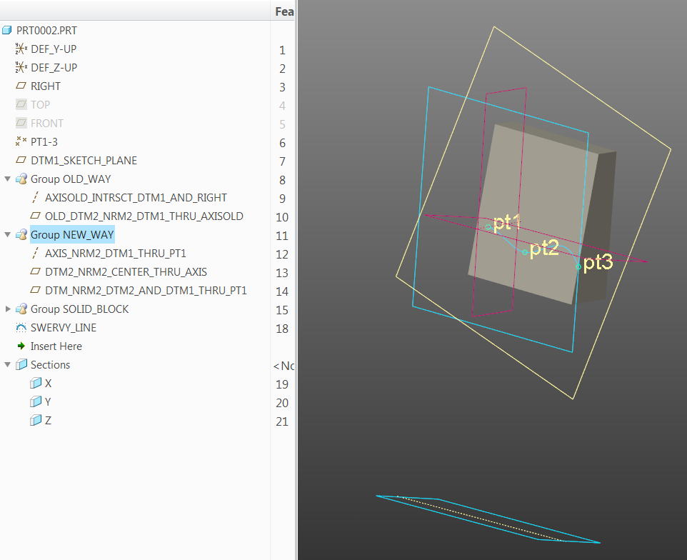

in the following 2 examples the horizontal planes are parallel.  in the "new way" the plane is always stuck to the datum point but needs an extra datum plane to define it,  But it is 100% parallel, and will never cause the bounding box issue.
new way highlighted
old way highlighted
