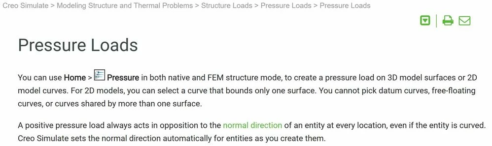

Based upon the Help Center, it is not possible to produce a distribution other than normal to the surface.

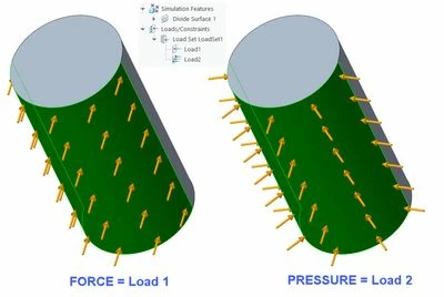

Thanks for the file.  However, that did not address what I was attempting, but close.  I am looking for pressure not force.  I tried the interpolation technique for pressure, but the pressure is still normal to the surface.  It will work for force.  The below image shows force vs pressure when using the same interpolation technique.  I am attempting this for a project, and I saw that it can be done in ANSYS, for pressure.  I have not tried it using (fx).  In the image of two cylinders, I am trying to get the pressure distribution to look like the force distribution.  The image on the left can be obtained by just splitting the surface and interpolation is not needed.

Perhaps I'm misunderstanding, but pressure has a magnitude, but not a direction. It is a scalar quantity, not a vector quantity. The resultant force on the surface of the part is in the direction of the normal to the surface, not an arbitrary one.
