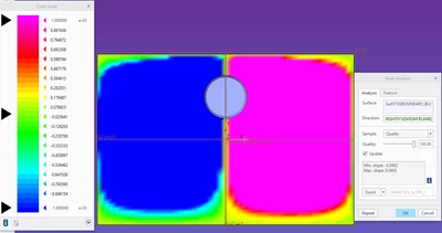

Hi
Any best practices for checking for pooling.
We are lookign to see if there are any low spots/dips etc that would cause a liquid tp pool if it was poured in there
We have Creo 7 with no additional analysis extensions
Tom
kdirth
kdirthAnswer
Dec 10, 2021 8:15 PM UTC
Installed level, I would expect it to drain, discounting other factors.  There are no "divots" in the surface.  The outer edges are level which could be an issue, especially in the corners.
Slope would be another way to look at it.
The yellow green color is at 0 slope - edges and corners.

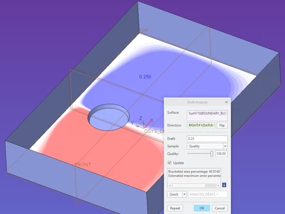

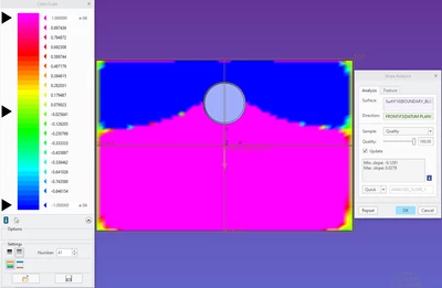

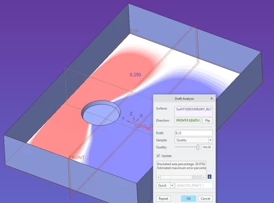

The simplest way I can think of is to use draft analysis fore aft and laterally.
TomB12348-GravelAuthor
8-Gravel
Dec 10, 2021 4:53 PM UTC
so based on those screens shots would you be confident in saying it would all drain (forgetting otherr factors like surface tensions etc.)
tbraxton
Dec 10, 2021 6:16 PM UTC
If you want to explicitly define a minimum slope to the drain you could revolve a section of a cone using an axis at the center of the drain with the slope you need. You can then intersect this with the vertical side walls. Consider how this pan would be leveled on installation to set the slope steep enough to work in practice.
