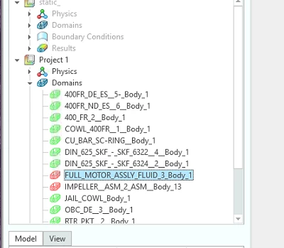

black color mesh domain in flow analysis
Anyone know why fluid domain color is red in flow analysis i have add fluid and solid domain and generate the mesh but it not generated for internal fluid domain i also attached the reference image
Aug 13, 2025 7:51 AM UTC
Similar question - "Flow Analysis Domain Icon Colors (Creo 7.0.9.0)": https://community.ptc.com/t5/Analysis/Flow-Analysis-Domain-Icon-Colors-Creo-7-0-9-0/td-p/883712

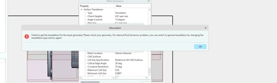

11-Garnet
Aug 14, 2025 3:07 PM UTC
Thanks, that was helpful. However, while meshing, I get an error in my model. I created a fluid domain and split it multiple times, but even when I tried with the complete domain, I still got the same error. When I switch to the general option, it generates multiple domains in additional domain.
