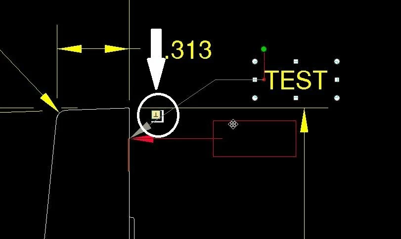

I use Creo 4, in the drawing
when I move a note or a bubble, there are always positioning constraints that appear, is there a way to disable this function?

to remove the constraints for bubble :
edit the attach, use a surface and change the arrow style to another simple arrow.

Another possible work around is by creating vertical and horizontal snap lines.
Have their intersection away from those pesky perpendicular or tangent snapping conditions.
Snap the corner of the leader to both lines, then move the lines into desired position by adjusting their spacing (can double click the snap line)

I found using surface reference selection instead of edge will stop the constraints.

This issue was fixed in May 2020 with the release of 4.0 M130 with the addition of controls  to disable and change the behavior of the constraints.
Check out this Idea post for more info: Option to disable/turn off annotation leader snapp... - PTC Community
