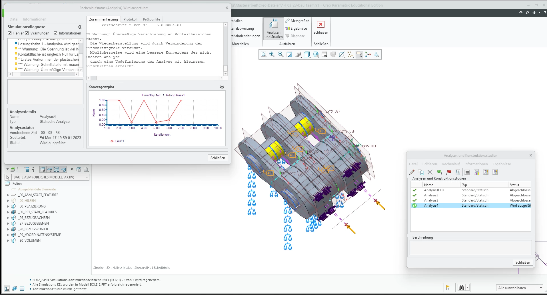

I've been trying to simulate the behavior of a hub_chain with multiple contacts for more than two months and haven't been able to get good results. I would like to know how a contact_simulation is possible with the software and which criteria have to be considered. I have already created several costing models, including some: Symmetry_Constraints. The chain consists of two pins and eight links.

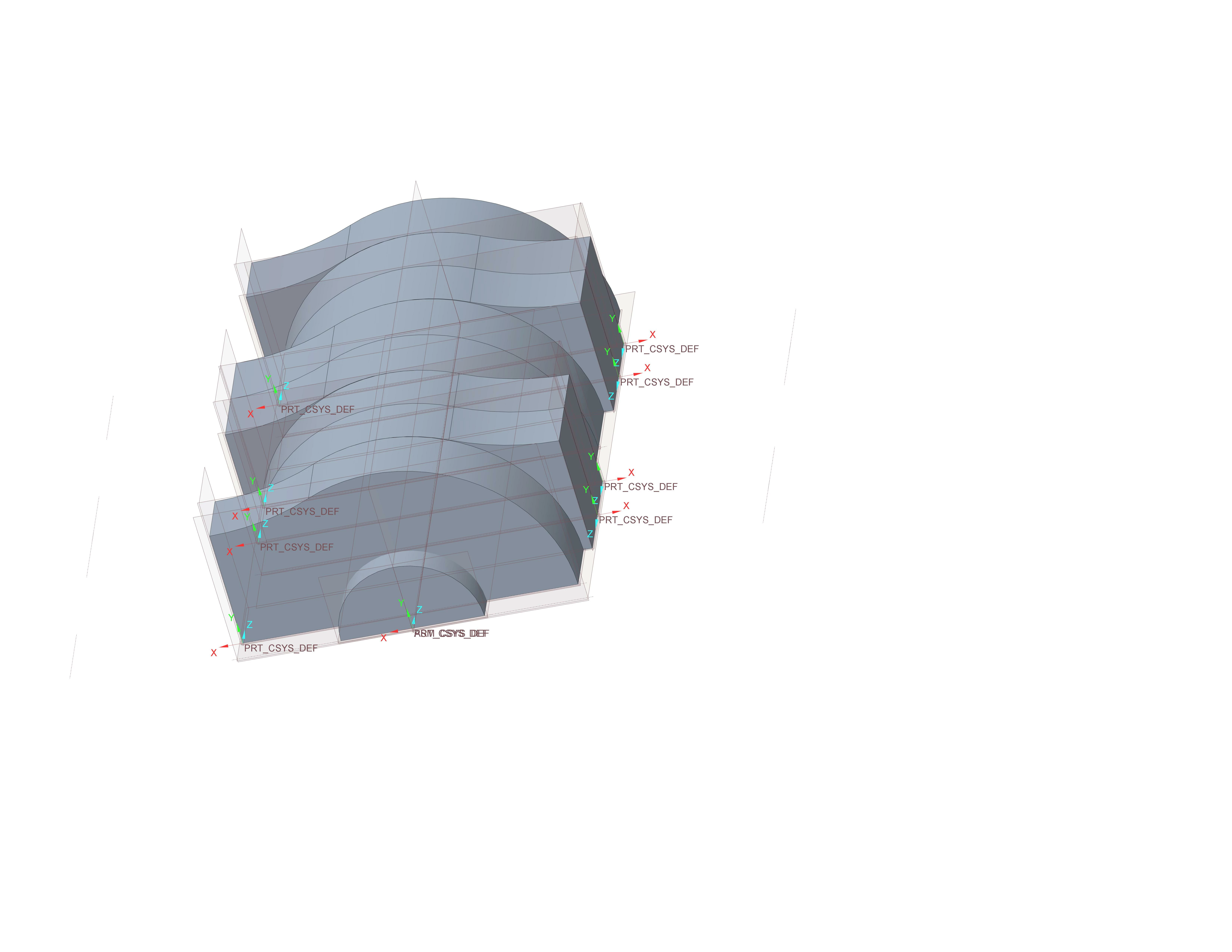

Do you have a STEP model for this?
I would halve or quarter the geometry (symmetry).

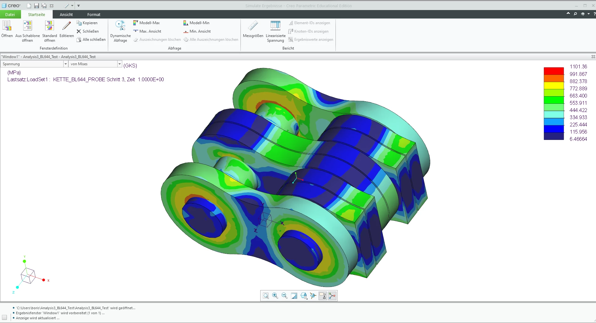

Thank you very much for your feedback. I hereby send the drawing. I'm sure I used all the boundary conditions but it still doesn't work. I either get an error message like "Excessive displacement or load factor changes"

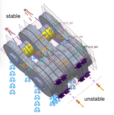

Better to pull than to push. --> Besser ziehen als drücken. (google translate)
I tried that too and it didn't work 😞
