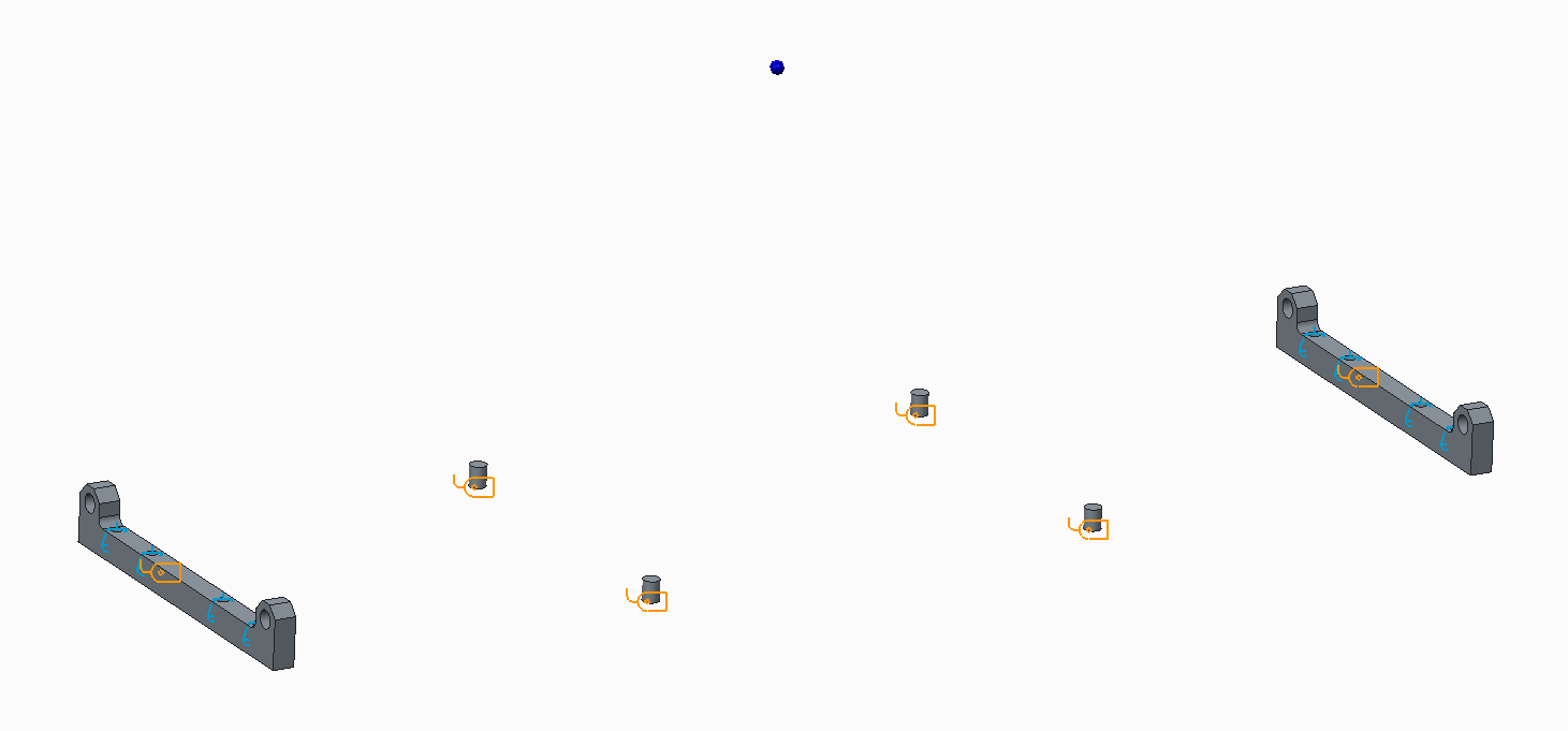

In this simulation I have a large box that is simplified to a point at its center of gravity (blue point in image above). The box is tied down to the floor using the 4 vertical locating pins and 4 horizontal pins going through the 2 pin block parts. I am trying to model the stresses in the pins and pin blocks, thus I need to transfer the inertial load of the point mass to these surfaces but only in the directions that make sense for the pin connections. How might I do this?

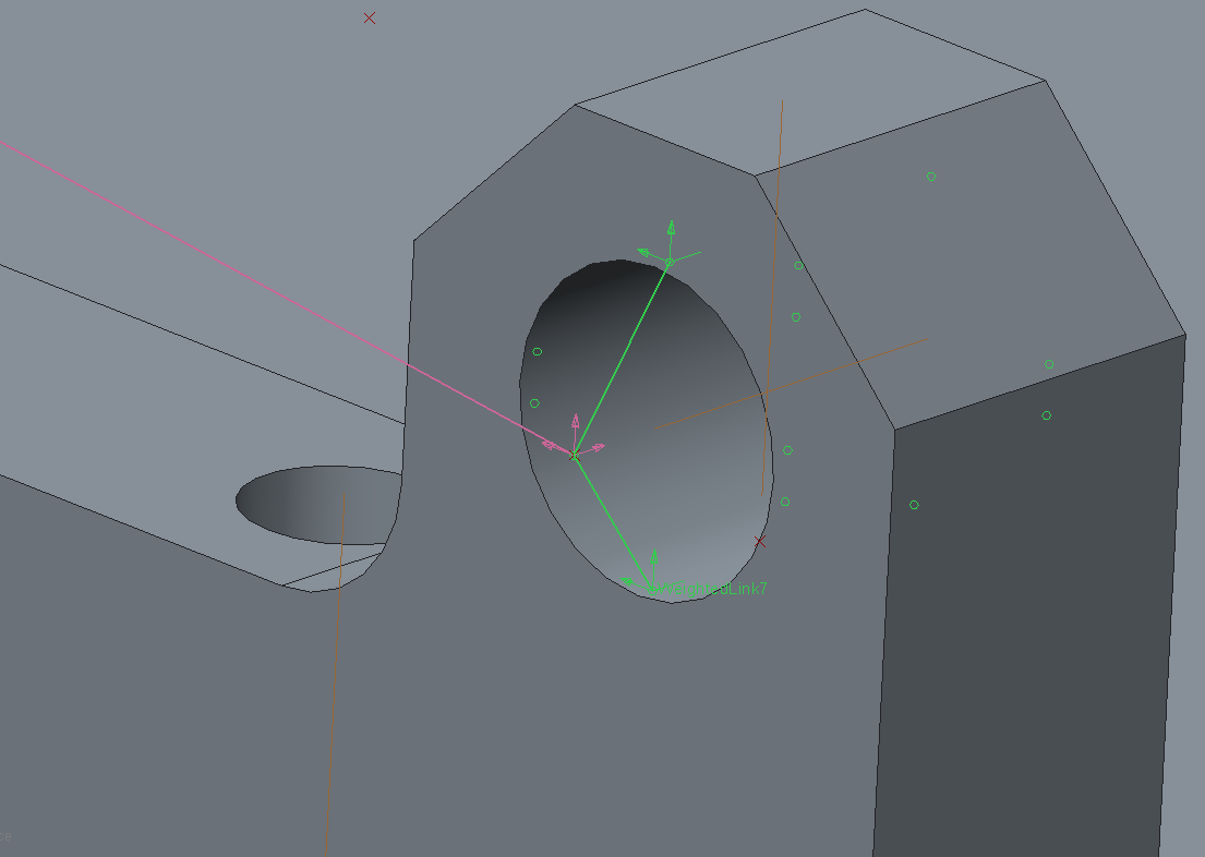

Thanks this seems like an approach that could work. However, in attempting this solution I discovered that I can connect two weighted links to a single point and define degrees of freedom in those weighted links. I figured I would give this a shot first.
I made a point along the axis of each pin and created weighted links from the pin surfaces to the points. While defining these weighted links I chose to constrain the degree of freedom along the axis of the pins. I then connected those points to the mass with one weighted link with all degrees of freedom enabled. The model ran and completed. Do you see any reason for this to misrepresent what I intended? Capture1.PNG
2-Explorer
March 24, 2014
Can you post more information on how you set up your weighted-links? As I understand your model, I would have expected you to get a collinear error due to how you defined your weighted-links.
