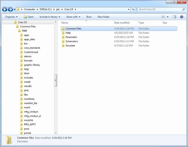

I was downloading Creo Direct 2.0, and when I went to install it even though I unchecked Parametric and Simulate, it proceeded to install them anyway. When I looked I noticed I had a new F001 folder inside the Common Files.
I looked at the version of Creo Parametric and it was now F001.
I didn't download F001 for Creo Parametric.
Turns out the download has all the software in one download. Even though you find a download under Creo Direct and another one under Creo Parametric. It's the same file.

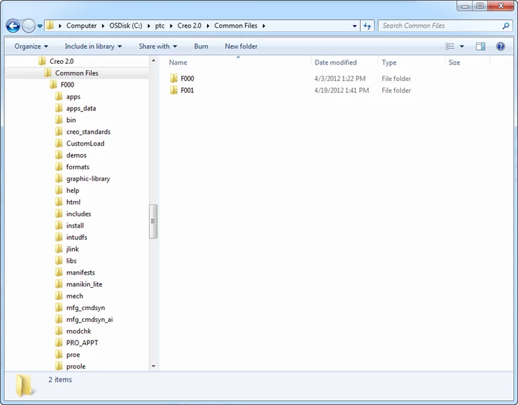

Apr 19, 2012 6:43 PM UTC
Also, the install does not overwrite the Common Files folders. It installs a new "date code" folder next to it for date code specific files.

Apr 19, 2012 6:52 PM UTC
Sorry didn't finish my thought... So all you need is a different launcher. You can have your build specific config.pro options in the common folder\text and just launch the build that you want without having them all installed correctly. This is moving forward of coarse so it doesn't solve the issue with the Wildfire installs.

davehaigh13-AquamarineAuthor
Apr 19, 2012 7:20 PM UTC
Well, actually, you can't do that.
Even though there is an F000 and F001 folder in the Common files folder.
The executable in the Parametric folder got updated to F001.
That F000 folder is dead wood, there is no executable left that is F000
The only way to have different maintenance releases is to install them in different load points.
