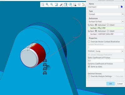

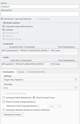

Hello Team,
I am trying to run the non-linear analysis for assembly with contacts. After running every time, it gives below error,  can you please advise, what can be possible solution to this?
Below are some snapshots to show the model i have setup:
For Pin connection:

Static Analysis "Analysis1":
Contact Analysis
Large Deformation Analysis
  Convergence Method: Single-Pass Adaptive
  Plotting Grid:      4

        Time Step 2 of 6:    2.00000e-01
The design study terminated abnormally.
The nonlinear iteration did not converge for the
time value:   1.95313e-04
  o The model may have a buckling mode with a load factor
    smaller than this value. You may determine the smallest
    (linear) buckling load factor by running a buckling
    analysis.
  o The deformations may be large enough that you must
    further refine the mesh. To locate potential problem
    areas, it may help to run an analysis with reduced
    loads and examine the deformed shape of the model.
  o The model may have a static instability.
  o  It is possible that the load is too large for the model's
     material or the model is insufficiently constrained. Check
     the constraints and material properties, or reduce the maximum load.

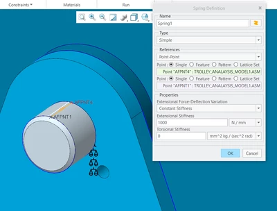

skunks
Oct 23, 2023 1:12 PM UTC
I basically do not use finite friction.
For "flying" parts like pins I use springs to base.
Would you like to have an example?

Yes please can you please provide detailed approach, how should i go about all contacts for pin? I have added frictional contact on pin diameter and hole surface. and spring for axial movement to restrict.
Also, should any changes done on config file for simulate to use?
