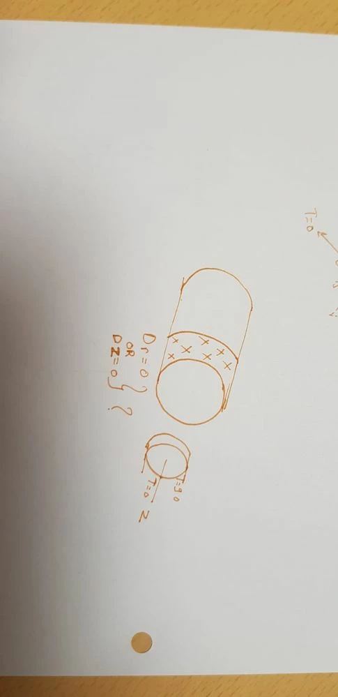

As Shown is figure, i have defined a cylindrical csys System
And i want to constrain the axial motion while allowing rotation of the shaft....
what is the difference if i am constraining Z or R
 I have tried pin joint which has same principle of working.... But the factor R is not clear to me in 3D models
what is the purpose of R

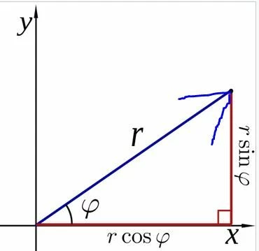

Cylindrical-Z = Cartesian-Z
x and y => r and phi

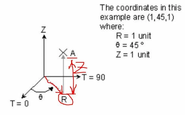

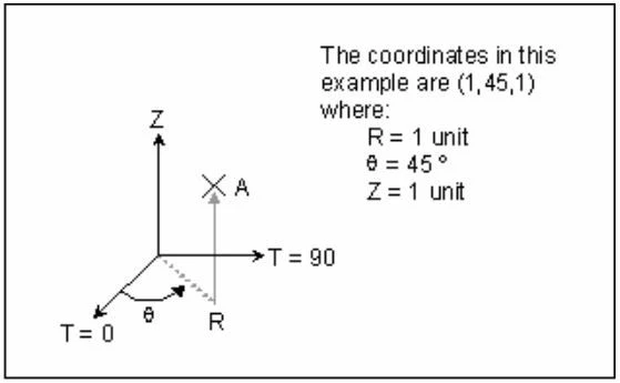

This image is copied from creo official website... And this differs from the explanation you are giving..
i also thought
R is movement in 3D
T is angular movement w.r.to Z as axis
and Z is axial axis have lateral movement
But according to the image on Creo website Z and R are same just having different position....
