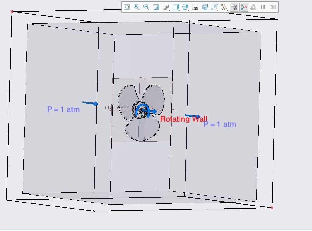

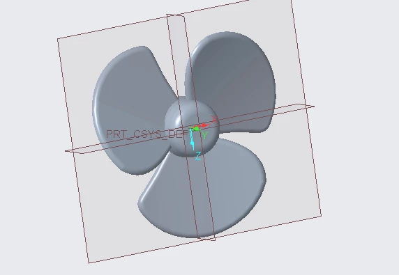

Hi. I have been trying to conduct flow analysis on a fan blade for quite a while now and I can't seem to get the right specifications. I have looked all over the internet and have only found flow analysis of internal structures, not external ones. I have tried so many things and can't seem to get it correctly. My project is due in a week and I am getting very stuck. Someone please help. Thanks
I’m not sure. It is a student account from my school so it might be the basic one. I may have figured out my solution tho. I set a pressure of 1.00001 atm going through as an inlet and a pressure of 0.99995 coming out. It seems to be working well as far as I understand. Do you think that makes sense?

You will end up with two fluid domains. One of them will be cylindrical and encapsulate the fan geometry. The other domain will represent the rest of your system. The cylindrical system will rotate at whatever your fan speed is. You'll have to define the axis of rotation and the rotation speed.

Thank you. Regarding the system, would that be a box around? and if so what would all the walls be? Is there an inlet and outlet pressure? This is what I have done already but it doesn't seem right. I am solving for velocity
There is a little demo in this video astarting at about the 10 minute mark. I know there is some documentation and tutorials on the PTC site, but I don't have the time to look for them. One of them is a mixer with rotating blades that would be perfect to review for this project.
