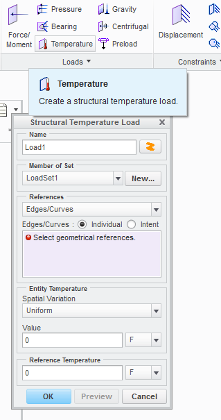

So I'm wondering what is the best method to fasten 3 components together and apply a preload? I'm running Creo 2.0 and I've had no issues using the advanced fastener tool with 2 components, however; I know that it cannot be used to fasten more than two components together.
I've done some searching, and using beams with a temperature load seems to be popular, however; I'm not exactly sure how to do this and constrain everything properly. I assume a round beam is to be created through the 3 components so as to simulate the bolt? I can do this without an issue, but I can't figure out how to "link" the beam with the temp. load.
Any advice, or other options, would be greatly appreciated!

What defines how to, "constrain everything properly" depends on what you're after results wise and what you want the joint to capture physics wise.
That being said, the most basic method for doing it is to use a beam element defined by a curve, weighted-links to "connect" the beam element the relevant components, and then apply a temperature load.
For the temperature load, you'll use structural temperature load (see image) and apply it along the curve you used to define your beam element. You'll need to play around with the total temperature change to capture the proper pre-load.

I appreciate the help on this. I was able to use a combination of springs and a displacement constraint in order to get my simulation working properly.
