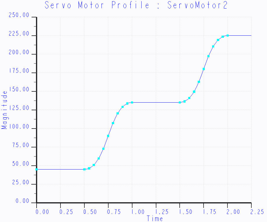

Andrew, can you post the graph for the servo definition you used?
June 13, 2014
Models are attached. The data points for the 1st and second driven wheels are attached also.
Here's a segment of the first driven wheel's servo motor profile. The drive wheel just has a constant velocity of 360 deg./sec.
I half derived the equation of motion for the driven wheel, but the third dimension really complicated it. I ended up just indexing the drive wheel and measured the angles directly.
