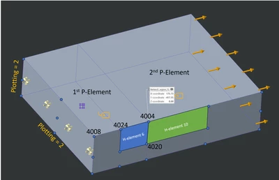

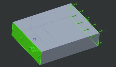

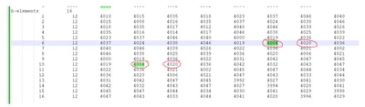

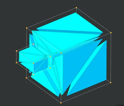

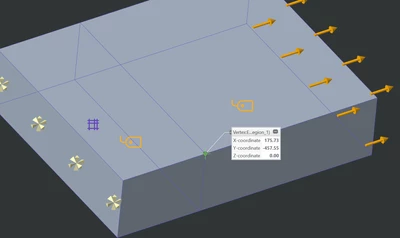

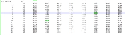

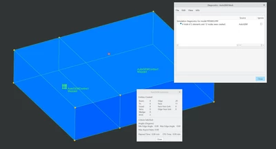

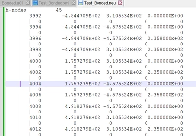

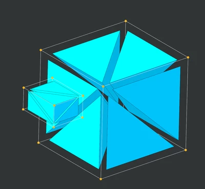

This is not the whole story, but the plotting h-elements share nodes across the bonded connection. (see Part 1) Bonded connection is not a TIE contact connection like traditional code. TIE would use constraint equations. In Hypermesh bonding is equivalent to imprinting elements to be the same on both matching bonded surfaces, then equivalencing the nodes. In Part 2 notice how the mesh changes for the bonded vs the free interface. Contact and Free interfaces will not enforce mesh equivalence.
PART 1
SweetPeasHub_0-1690817631122.pngSweetPeasHub_1-1690817699856.pngSweetPeasHub_2-1690817744988.pngSweetPeasHub_3-1690817866895.pngSweetPeasHub_4-1690818129425.png
PART 2
