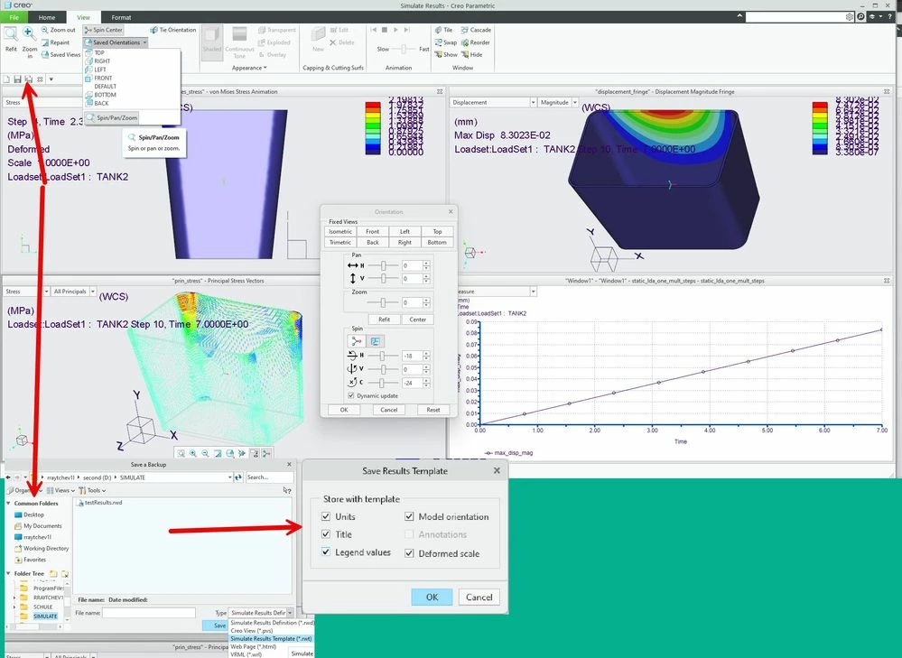

Hi @ilyachaban ,
I see that no answer here so checked it but seems for me not clear why such workflow should be used and what is the automation effect in that case.
so when I check Analysis in Creo Simulate I need to open it according to the steps ´described in:
https://support.ptc.com/help/creo/creo_pma/r11.0/usascii/index.html#page/simulate/simulate/resltui_loading.html

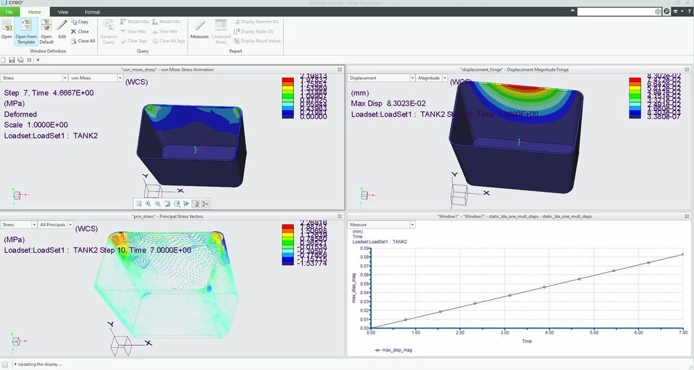

So when I open an simulation results:
here example above of static analysis with template provided by default in Creo simulate

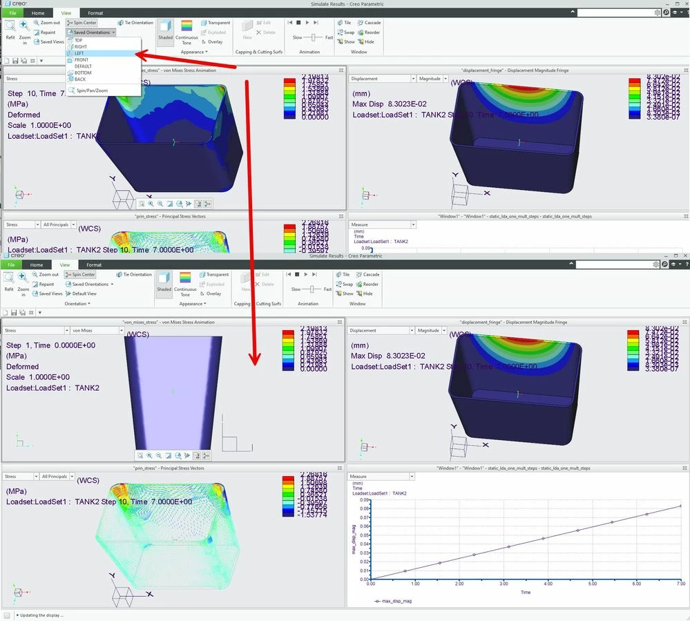

So I could set a view /predefined in Creo Simulate:
Or I could use dynamic view
or you could use simple activate a view by click on the view  and rotate with the Creo  by mouse with MMB . Later when you have the desired display you can save it then to rwt template - where we need to check that it should save also the model orientation - means that what you want to change later via python directly to the rwt file
For me is not clear what is the more value when you change the rwt file. Possibly you need then to open it and to take the picture but how , Therefore for me is not clear why should be better to have the automatic change of  rwt file. Possibly if you provide some details about your workflow will be helpful. e.g. how do you open the efile and then take the snapshot.
So here is not clear what you meant with recalculate. Why is that a  option which bad Performance? e.g. comparing e.g. to dynamic rotation?
So far I know the  rwt template contains  only metadata Information - e.g. the orientation. So means having the orientation we need to calculate from 3d result geometry  the 2d projection what is displayed in the  result window- it is always projection. What is different  in that case.?
What I believe , when there is an difference  - is that Simulate will see that the rwt file is changed and will interpret it as completely new rwt - so will not consider only the  view change what obviously is required in you case  but also every thing because possibly the dev team did not indented such workflow so via manually  change of rwt and reopen it.
But as mentioned it depends on your workflow to say what could be an alternative techniques . Do you use some kind of trail file or else ( e.g. Creo Toolkit) in background to start the simulate results?
