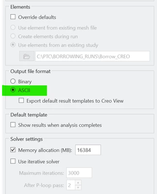

The answer is that all versions of Creo Simulate allow ASCII output format.
The output folder will have human readable text, however the format is complex. Even though your question does not ask about interpreting the text output, I will answer that with a link to the question where this was answered best.

Those results are visual results (ie modal animations or fringe plots). If you want the result of something (ie max stress or displacements, etc) then you need to setup a measurement. The measurements get put into the result .rpt file as text. Depending on your measurement (for instance if you are doing a transient measurement) there is a way to save it directly to Excel from the output graph dialog box.
