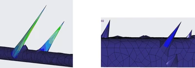

See above screenshot, the spikes of stress calculations among shell elements. Does anyone see this before?! The stresses should be less than 20ksi, however, these spikes are around 2.0e+7 ksi. I am using Simulate 6.

Please give us more information. If you can attach a zip file that would help greatly. My only comment on the images is that the elements look strangely shaped.

The image on the left side shows the shell elements of a metal bracket of thickness 0.1". The image on the right side shows the von Mises stress distribution in the latest simulation just now. There is no more "spikes" shown in yesterday's post.
It never happened before according to my limited memory.
On yesterday afternoon, when the "spikes" showed up, Simulate popped up a message "Fatal error encountered", then quitted.
