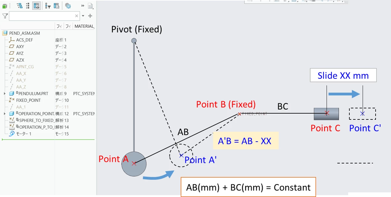

I would like to simulate a mechanism consisting of a pendulum (Point A), a pulley (Point B), and a slider (Point C) in an assembly.
The conditions are:
- The wire between Point A and Point C is inextensible (constant length, no stretch, no slack).
- The wire passes over Point B (pulley).
- The pendulum is rigid one-part.
My questions are:
1. Is it possible to build such an assembly model using relations or other Creo mechanisms?
2. Can this model be used for motion simulation in MDO (Mechanism Dynamics Option)?
I tried using relations based on measured distances (Analysis → Measure).
However, it seems that the measure feature cannot be used on the left-hand side of a relation, so I could not enforce the constraint properly.
Does anyone have suggestions for modeling this kind of system in Creo?
(I am useing Creo11)
Thank you in advance.

I simulated wire by using Slider Constraint and Gear Connection.
Then I can measure load of one pulling motor

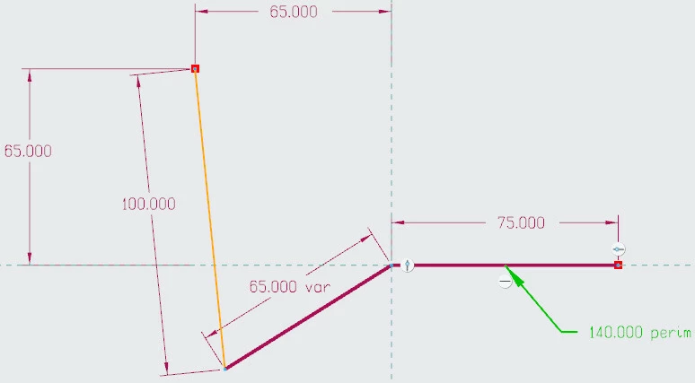

For example, create a control sketch in which you can define the constraints you need using the perimeter dimension
Van_AG
May 27, 2026 11:37 AM UTC
Please take a look at the attached example of a mechanism built to your specifications. I created it using a motion skeleton, but it can also be built using standard parts. The `body_skel_ground` in the example is optional, but if you remove it, you won’t be able to redefine the connections for `body_skel_001`. The mechanism includes two servo motors with identical motion profiles.
