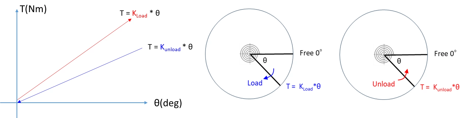

How to model different spring stiffness for loading and unloading in Creo Mechanism (MDO)
In Creo Mechanism (MDO) motion simulation,
I would like to use different spring constants for the loading and unloading (return) directions, in order to represent spring hysteresis.
Is there any way to simulate this behavior in MDO?
If not directly supported, what is the recommended workaround?

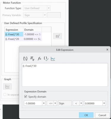

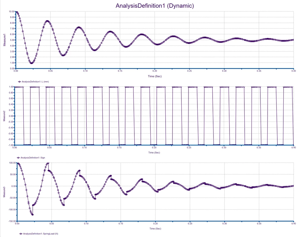

Feb 2, 2026 4:01 PM UTC
MDO does not have nonlinear spring.
Also, relations are not linked/updated to measures during analysis. (limited usage)
The proper way is with a force/torque motor with the math necessary.
This is linear spring example. You should be able to apply similarly to torsion spring.
Setup measures: Lengthofspring(L), Velocityofspringjoint(VelX)
user defined measures:
FreeLength(FreeL) = 5.0 (just a number to capture the free length)
Sign = ((FreeL-L)*VelX)/abs(((FreeL-L)*VelX))
Make force/torque Motor with primary variable Sign.
Set domain for sign positive and one for negative.
Each with force based on spring length
(L-FreeL) * 30    Domain(-1.0 <= Sign < 0.0)
(L-FreeL) * 20   Domain(0.0 <= Sign <= 1.0)
Note: The signs of measures matter, check simulation and reverse Rate1 Rate2 if necessary.
If visualization of the spring is desired, place a very low stiffness spring, otherwise only the force motor applies the representation of the spring.
Also, as a pro tip, many things like friction, aerodynamic drag, etc. can be applied as equations within force motors.
