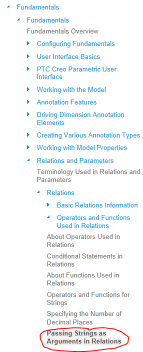

To get to the page with the information on it, I manually navigated down to where I knew it was.

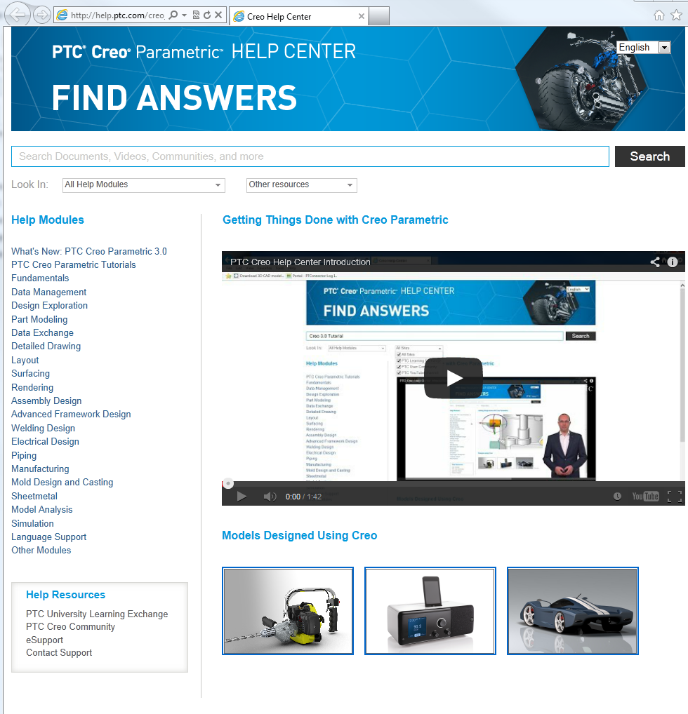

Pick the question mark in the corner:
This takes me to the help center (on PTC's website)
http://help.ptc.com/creo_hc/creo30_pma_hc/usascii/home.html
From there drill down to the topic:

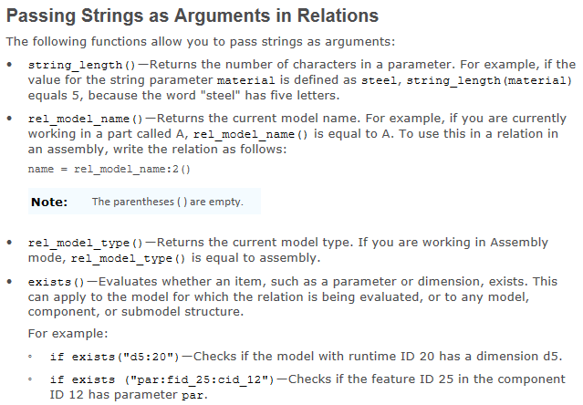

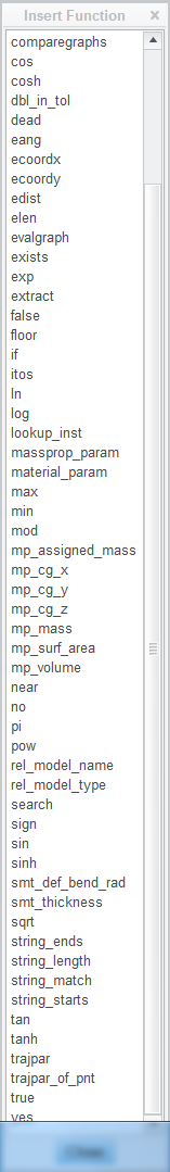

It is in the list of functions, yes.
July 25, 2014
Yes, still there. From Creo 3.0 F000 Help:

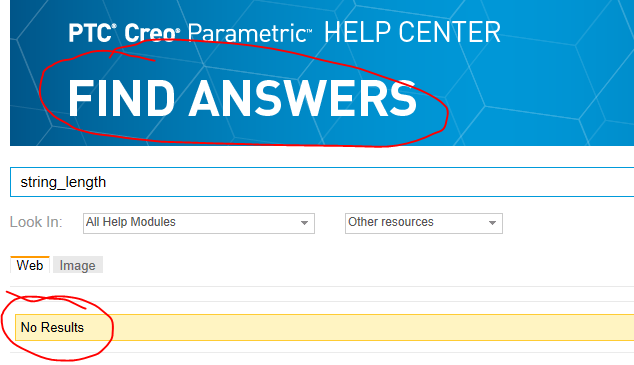

Of course the newfangled help isn't smart enough to find it.
