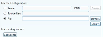

If you open Mathcad independently from Creo there is an option to set the license.
If your company has a floating license system, and a high enough package type, there may be floating licenses of Mathcad available from the license server. If you are using locked licenses and a package that includes Mathcad, the license may not have been selected when generating the license file for your local machine, and Mathcad would need to be added and a new license file generated. Also, if a locked license file was used for Mathcad for a previous user on your computer, it may just be a matter of the license file not being in a location that you have user rights to access.
