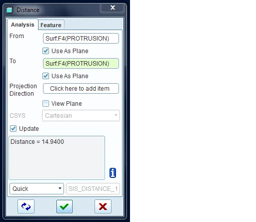

I would like to be able to hit a button and take a picture of the measured dimension and it's value.
Currently I use a different program to window around and screen copy because the measure goes away if you try to hit File >Save As>*.JPG

If you go to Start>>AllPrograms>>Accessories>>Snipping Tool, Right-Click on Snipping Tool and then Click Pin to Start Menu.
Then, when you are doing a measurement, you can hit your Windows Keys (between the CTRL & ALT keys on left side of spacebar). That will open the Start Menu, and Run the Snipping Tool. You can then drag a window and copy and paste to email, Paint, or wherever you need to copy the image. If you want to save the image, I usually run Paint, and then save from there. I have Paint pinned to my Start Menu, as well, so I can get to it with the Windows Key. I have attached a sample of a snipped image.
Hope this helps...Brian
