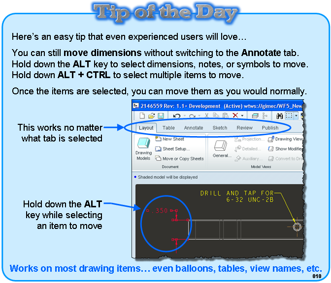

Why is it that in WF5 drawing mode, you cannot select items on the drawing without being on the proper tab? THIS HAS CREATED EXTREME USER FRUSTRATION & INCREASED TIME TO CARRY OUT FUNCTIONS. Not to mention added mouse clicks. To edit text you MUST be in the annotate tab, to carry out simple table functions MUST Table tab, if you want to change the display of a view you MUST be in the Layout tab. If you need to carry out advanced functions, then it makes sense to be on that tab. JUST BECAUSE SOMEONE THOUGHT IT MIGHT BE A GOOD IDEA, IT MAY NOT BE SO.
I would really like to know how they even thoguht this would be a good idea. Just another example of PTC adding effort to our design/documentaion time.

I understand your frustration. However, there's a way to select items and move dimensions, notes, symbols, etc without being on the Annotate tab. Simply hold down the ALT key and you'll be able to pick items no matter which tab is active.
Hold down ALT + CTRL to select multiple items. Once we starting using this, it dramatically cut down on the number of complaints we received. I made a tip for our users documenting it... I've attached the tip below.
Does this help?
Thanks!
-Brian
