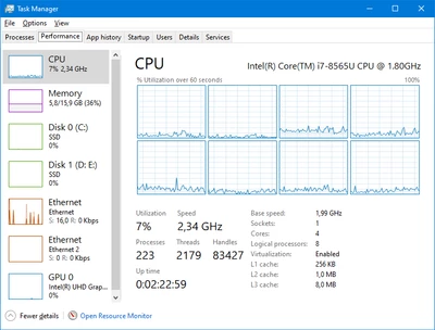

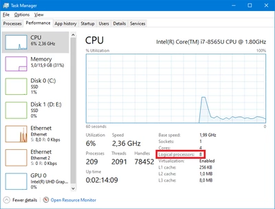

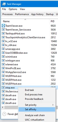

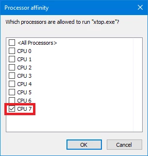

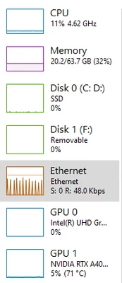

just couple of notes ...
1.] most of Creo actions are single threaded ... this means Creo uses 1 logical processor, only
2.] your picture shows that overall processor load is 11%
3.] let's say that your your CPU has 8 logical processors (see following picture)
4.] when your CPU had 1 logical processor then it would be 88% loaded ... 8 * 11% = 88%
5.] you can apply Set affinity command to xtop.exe and force xtop.exe to use only 1 logical processor
6.] task manager can be configured to display load of every single logical procesor ... you can see that CPU 7 load is 88% (in your case)
