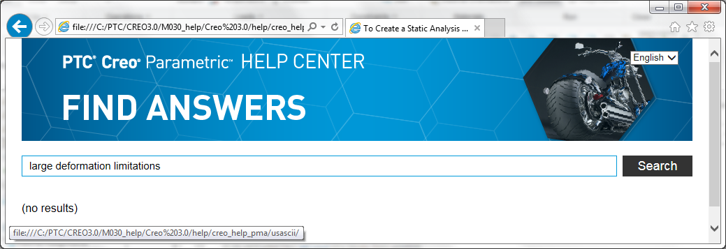

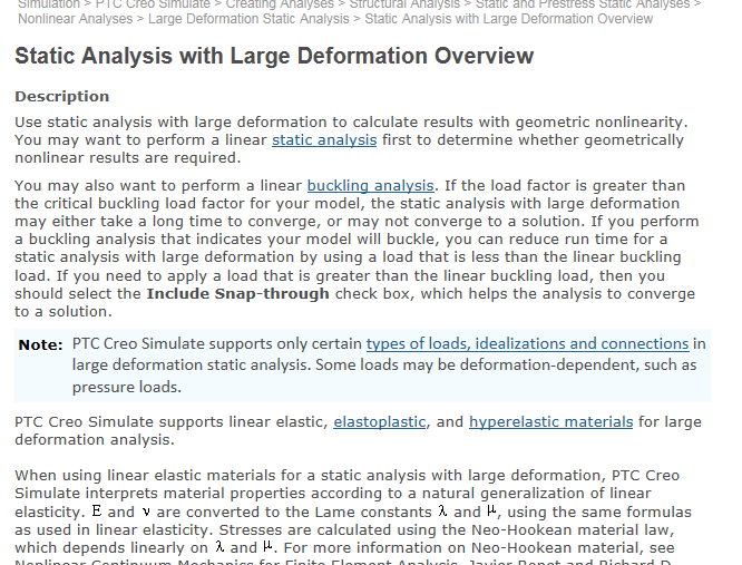

    I did check the help files. The help files ...
    The overview should have a list of limitations as a MAJOR heading in the overview and therefore UN-miss-able.
    Nothing in the help is immediately obvious or maybe I use it the wrong way.

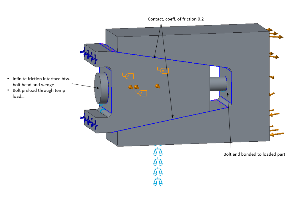

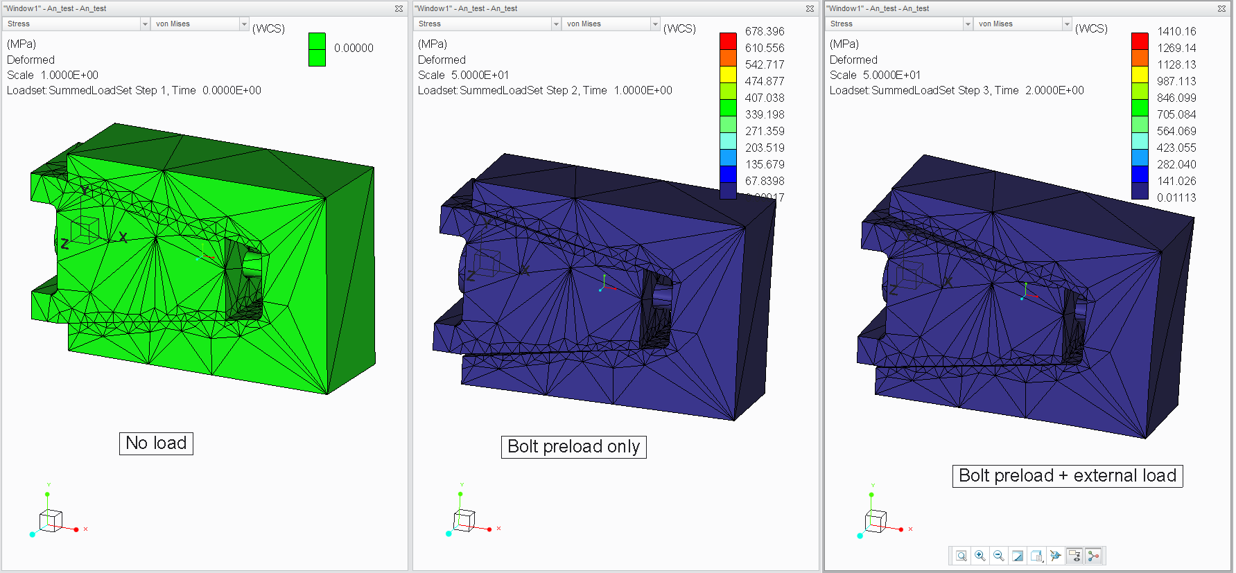

    Just to demonstrate, I make a quick test with a model that requires large deformation analysis, in a pre-loaded structure, but where deformations may seem small.
    A bolt maintains a pre-load on a wedge that holds a component. An external load is applied to the part held by the bolt/wedge arrangement. I want to include the effect of shear/bending of the bolt; this is why it is necessary to use large deformation analysis - the problem is statically indeterminate.
    The load is applied in two steps, first a pre-load to tighten the bolt, then the external load is applied. This is accomplished by using different time functions in the analysis form.
    In a contact analysis like this, even though deformations are seemingly small, they are significant in comparison to the stiffness of the structure. This is a typical example where I would like to be able to include beam elements in a large deformation analysis, to model the bolt. In this simple example, it worked fine with a single solid bolt, but if there are many of them, and/or the model is otherwise complex, some component has material nonlinearity etc, I don't want to model bolts like this. I want to be able to include beam elements.
    This model contains 3970 elements, took about 15 mins on my laptop (64 bit, 16 GB RAM, 2x2.7 GHz) It was made in Creo 3.0.
