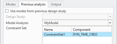

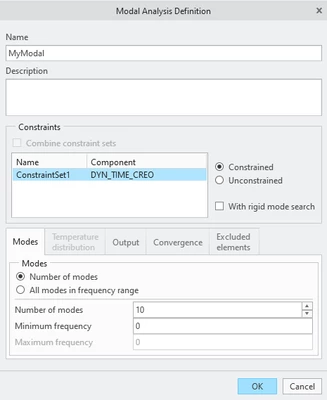

1. Define a modal analysis
a) constrain the model (unless doing free-free study)
b) set number of modes or frequency range. For dynamic time I suggest at least the first 10 modes.
2. If doing "load functions" add a unit load to your model in the location you need the dynamic load. Base excitation is loaded through the constraints like a fixture placed on a dynamic shaker machine.
3. Define a Dynamic Time analysis
a) reference the previously defined modal analysis (can choose to run on demand or a pre-run study)
b) Choose the load type: Load Function / Base excitation, the acceleration direction or the previously defined load-set.

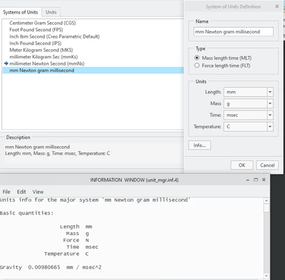

thank you for the steps it really helped. i am just not able to plot acceleration VS time plot of the results, please guide me through that. in addition to this I just wanted to confirm that the units of the time steps that are being displayed are in seconds right?
Mar 20, 2024 12:58 PM UTC
The time unit is by your unit system for which all of the built-in units are in seconds.
But, a custom unit system could be made, for example the common millisecond time base for dynamic analysis.
