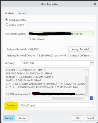

My current approach is to open the part/subassembly to idealize, do mass properties, enable X/Y/Z COG features, then create an offset point with relations using those features to define it. Then I return to the assembly simulation and create an assembly datum point at the assy level defined by the COG location point within the part. Then I use refine - create mass - mass by part on the assy level datum point (thats when the notification about double mass pops up). Finally I go back into the part level, create a simplified rep with all solid geom features excluded, then return to the assy simulation and use this simplified rep.

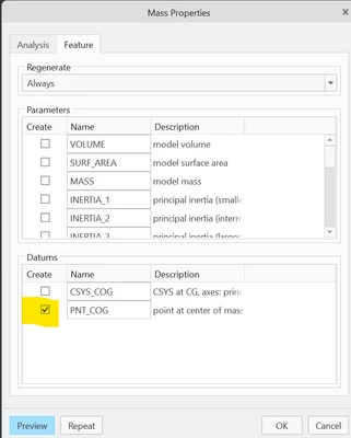

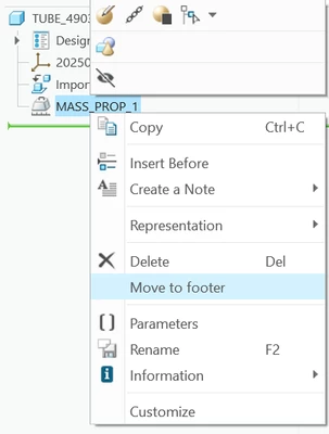

  • To streamline use a Parametric license with behavioral modelling that allows automatic creation of point or csy at cog. This will automatically update to the value at where the measure feature is in the model tree. Moving to the footer is the most common situation but in a rare case you might want to take the mass before some additional features are added.
  • if you really want the component at point to follow exactly at the cog, even though that is not necessary...
    • In another simplified rep or the master rep with the component included, make a point at the assembly level that is ON the cog point (from the analysis feature) in the part . This creates a relationship that will update when regenerating, but only if the referenced component is included at the time of regeneration. This means some switching between reps to do an update, but then this new point can be referenced even when the part is excluded because it is in a part or assembly that is not excluded.
